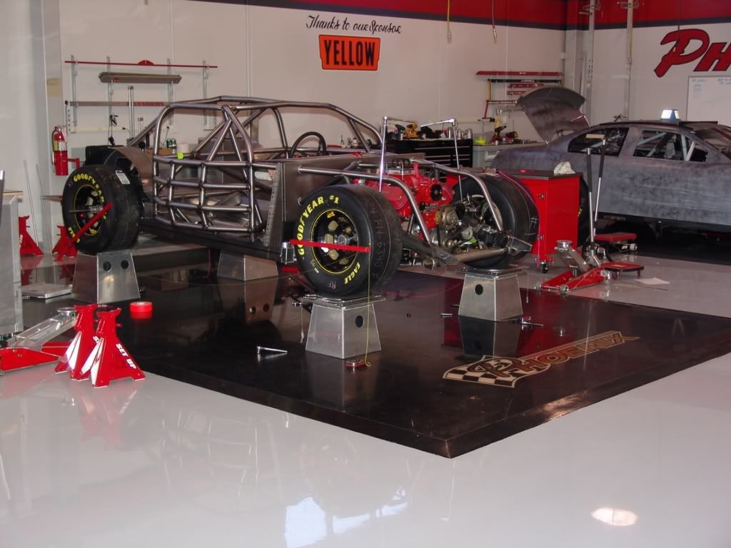

you can adjust weight percentages.......or the cross, diagonal, whatever you want to call it without f-ing up the ride heights with even turns on front and rear spring adjustments, be it coil over or conventional with jack screws.
i can have a car at the correct hieghts with 64% cross, when you want a RR car to be at 50%, on a standard 1/8" per turn adjuster that would take about 5 turns on each corner to get back to 50 and the heights wouldn't change.
RIDE HEIGHTS WILL NOT TELL YOU THAT YOUR WEIGHTS ARE CORRECT, see above
this is how our alignments start, and it's done with no springs and the chassis blocked up to get the roll centers where they belong.
