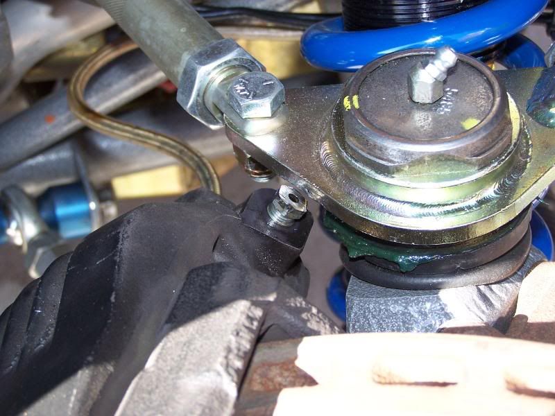

Do you have a spacer between the nut and the spherical joint? I can't really tell.
ps: that's a crazy tall bumpsteer stack even with '96+ spindles. Eek.

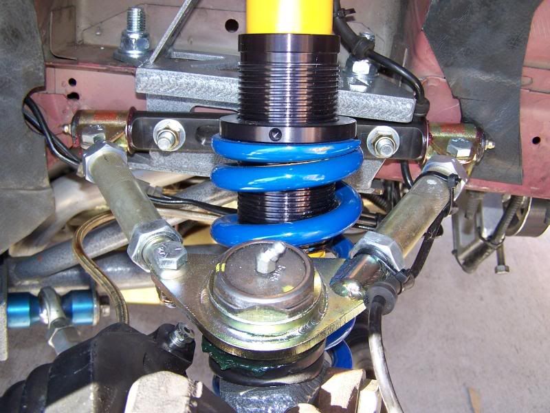

Yes, I was asking you.
Just an observation here not a criticism.
This picture:
It doesn't look like you have a spacer between the nut and the joint. Depending on the amount that the spindle moves up and down, it may cause the nut to contact the outer part of the joint. It doesn't mean that it will but it's just something I noticed when looking through the pictures.
And, for the lazy people...
I'll keep my thoughts about the interesting bleeder screw "mods" to myself.
Still, it's some nice shiny hardware.

I, too, am surprised at how tall that spacer stack is. That looks even taller than on my car, which has the '94/95 spindles with the higher steering arm. Looks like the tie rods are lined up nicely with the control arms, though, soooo...
I never thought about that. I'll check it out next time I get the car up in the air (tomorrow probably) and see if they contact each other while turning and/or when the suspension is compressin or expanding.

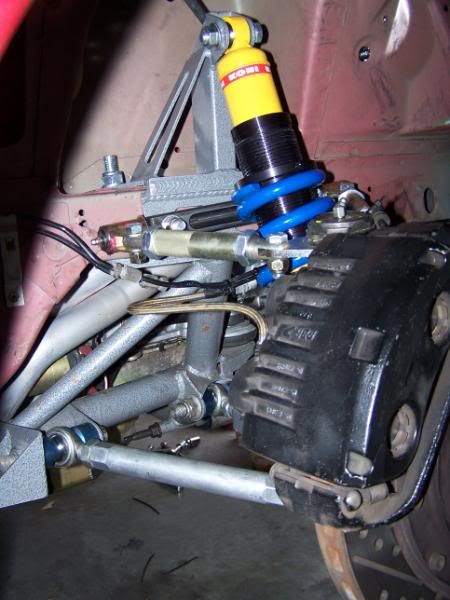

Look at the second picture of post #4, you can see the bottom bolt is stock. The top one is something Griggs sends you depending on which brakes you have. In my case 03-04 Cobra brakes. It's a bolt that's threaded on both ends. It's kind of like a jig saw puzzle. You need to put one end of that bolt in the caliper, then put the rotor in the caliper and then slide them on the spindle as one. Then but the bottom bolt in, then put the lock washer and nut on the top one, then tighten both down. Or that's how I did it
You can't put it in on after the caliper is already mounted to the spindle, the part on that bracket where the upper ball joint bolts on is in the way.
It was pretty easy, just took some time to figure it all out.
