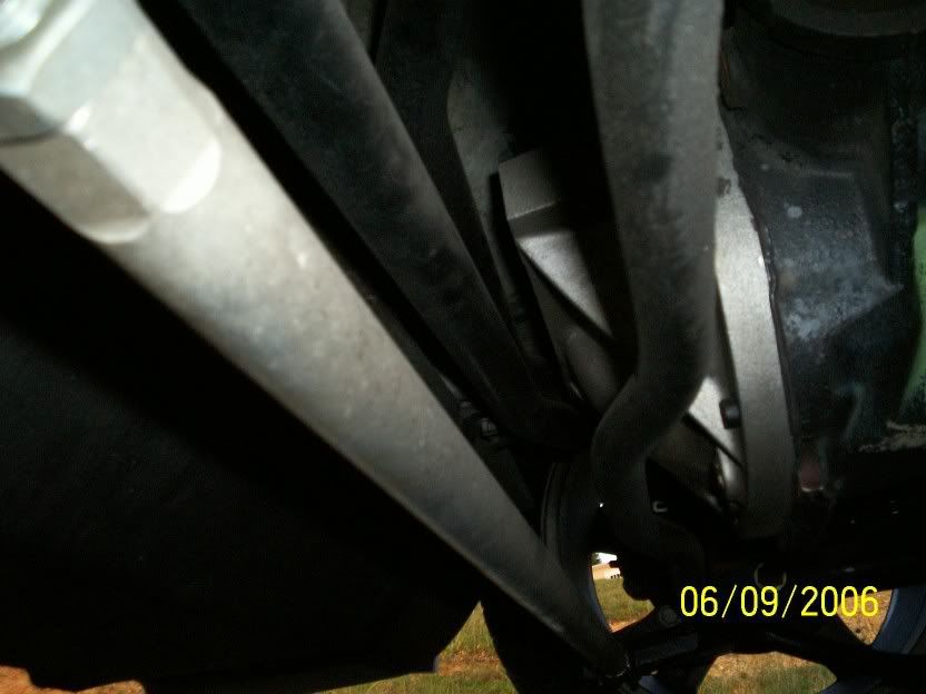

It's REALLY close with the T/A Perf. one, but it's THICK.
