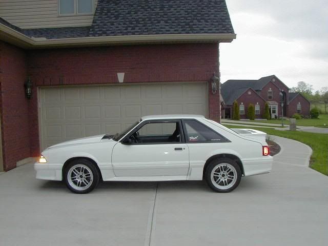

Originally Posted by jaysch302 View Post
i was just looking at those wheels you have the sbc coating ? does that make them heavier?
That's not my car just one of the two fox's I could find pics of with these wheels. And I believe the weight is with the coating. People I autocross with that have these wheels swear by them.
Mine will be ordered next month when I get my bonus.
This is my car with Enkei V1's on it wich are pretty light but don't really fit the car.
And you can see I have 13" cobra front's and to am thinking of getting the Brembo 4 piston calipers.
