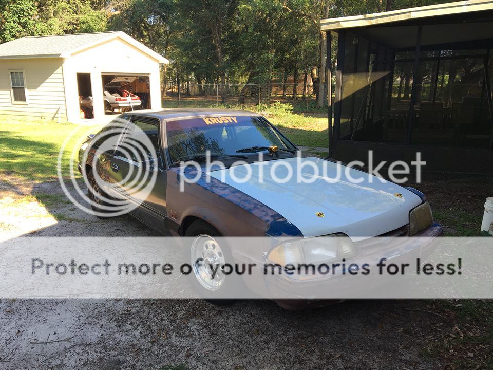

Just got this turd running as a "joke" car..............
junkyard explorer 302 shortblock
lunati 51025
Old iron hi-ports 1.94/1.60
Vortech upper with systemax lower
80mm maf/75 tb 30lb inj
stock fuel system with 340 in the tank
1-3/4 LT's with junkyard 4" bullets
modded v6 t-5
4.10's with 6 year old 26x10 mickeys
Struts/shocks.....solid upper/lowers in the rear, moroso tricks in the front..........
Just got it to the track a few weeks ago...ran a best of [email protected] on motor at roughly 2900+lbs....+2600 DA, 85% humidity and 140+ degree track temp..........going to hit it with a 150 shark nozzle once we get a few more hits, some new slicks and a decent ignition box.....plus a little street testing.........good news is we got all the bodywork and interior lookin perfect!
