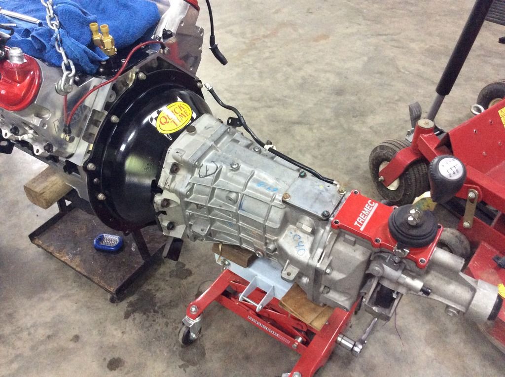

I have a 5.3 based ERL 454ci engine with a custom QuickTime bellhousing for a Ford spec T56 Magnum.

When I ordered mine (2014) there wasn't a part number because they had never built one. Last month at PRI I talked to Ross McCombs and he said QuickTime is, or will be in the future, mass producing them. I checked their web site and the application isn't listed...(We couldn't find what you're looking for. Ask our experts: 1-866-464-6553)
If that doesn't work let me know and I'll give you another number.
