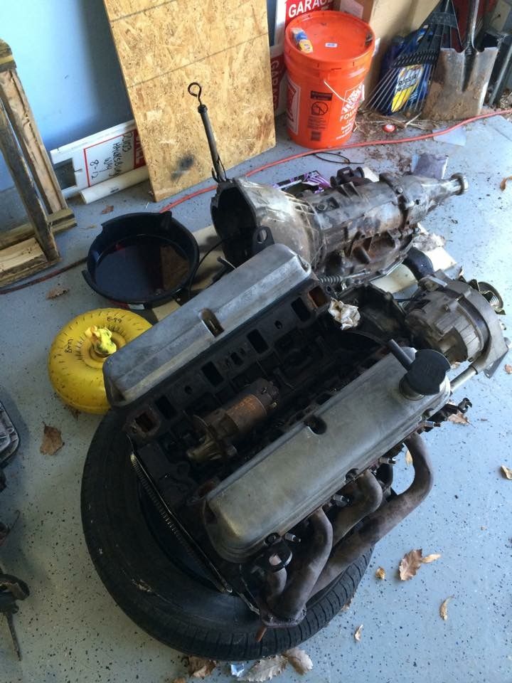

Well I wish I could tell you this was some off the wall different setup but Id be lying.. Its your typically BUDGET LS turbo fox. I would say 90% of the parts are used. As of yesterday I have owned the car for 2 years and its already done some street racing and been in a few videos. Figured it was time to throw it up on TECH.
Quick run down:
04 LM7 5.3 {regapped rings##
228/228 cam
pac springs
ls9 headgaskets
ebay headstuds
s475
th400 manual vb
e85
160lb injectors
magnafuel 4303
Sorry for the pics being in black and white. Only a handful of people knew about the build until till ran.

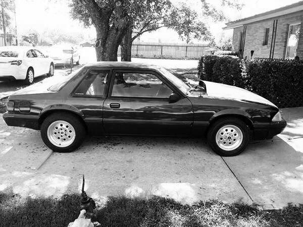

How I bought the car

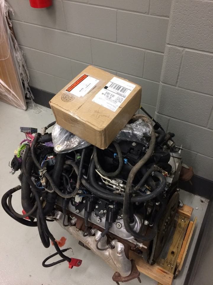

5.3
Without these two I couldn't have done it!! Two kick azz guys
100% NOT BRAND LOYAL

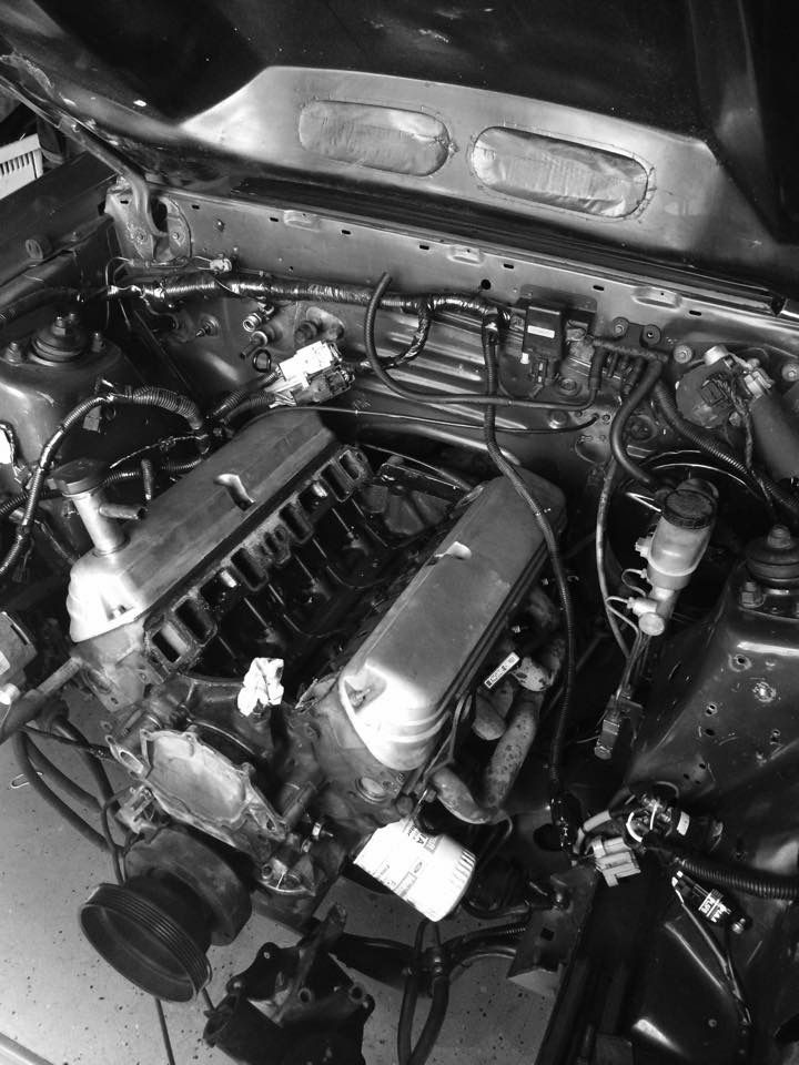

my buddy kevin did all the wiring!! amazing job!
before
after

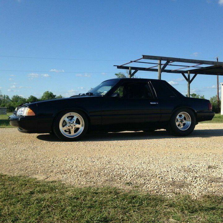

And her it is!!! Yes its a POS!! just the look I was going for....
