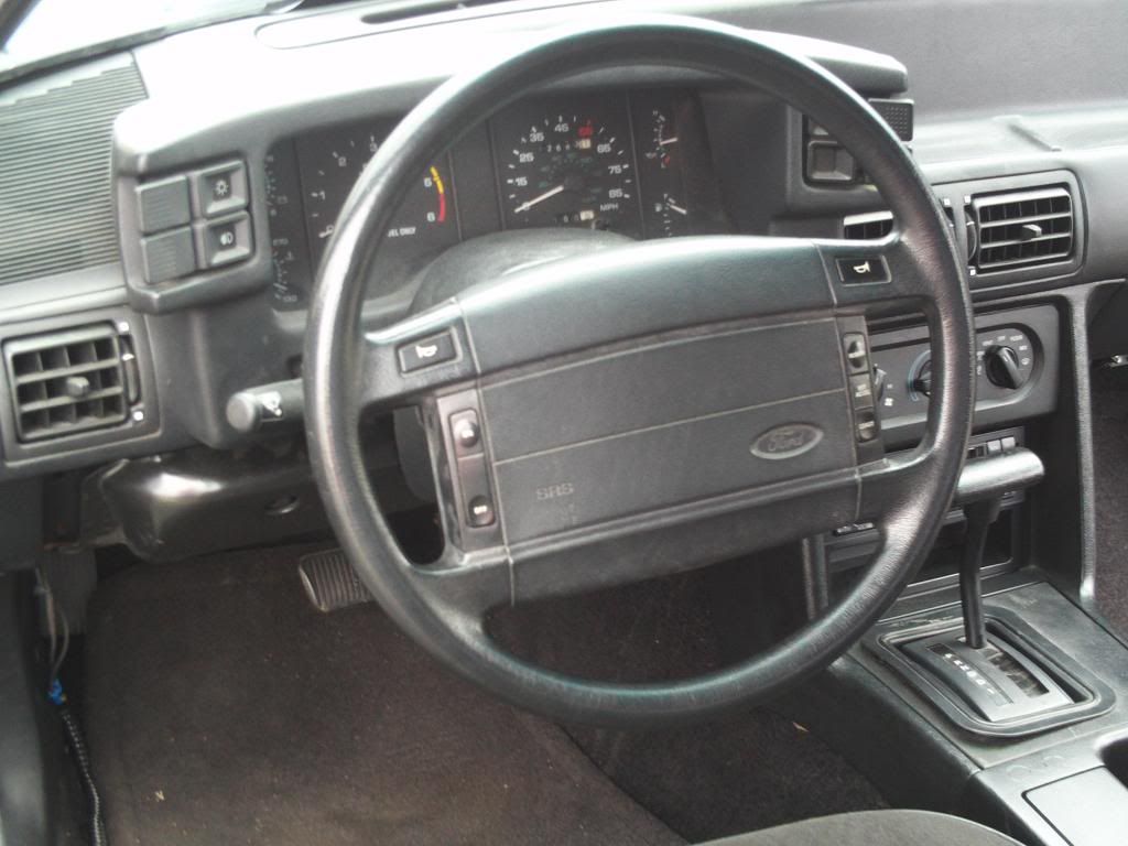

Hello everybody! I figured I would share my build on here for fun as well as for those who may have questions about this type of swap. My main goal with this build was simplicity. It is a street car that is a light, no options, plain looking, deceiving beast. I started with a 1989 4 cylinder 5 speed coupe that was owned by a grandma. I bought it as a roller and went from there.
Rundown:
- LS2 with 243 heads, JE Pistons, LS6 intake, Tick custom grind cam, 42LB injectors
- 4L60E with a full manual transgo HD3 kit, beast shell, band, Hughes frictions, corvette servo, and a Vigilante 3600 rpm converter.
- Headman mid-length headers with full 3" X-pipe and magnaflow bullet style mufflers
- 8.8 with 3.90 gears
- Tubular front end, 14" x 130 lb coil-overs, front 90-10s, rear strange shocks, 4 wheel disc brakes.
- Painless chassis harness, standalone engine harness made from an LS1 unit
- Manual brakes, trans, steering, windows, and even mirrors!
When first bought: sat for 4 years

After stripping the original wiring I began to install the Painless kit. I mounted the fuse box near the passenger floor board.
I mounted the starter solenoid in the trunk next to the battery
For the engine wiring i made a PCM mount and put it under the dash behind the glovebox. Easy access to everything.
I used the factory gauge cluster and mounted all new gauges in a piece of carbon fiber I cut up. Turned out really slick!

Final updates
On the interior I bought some black carpet but have already removed all sound deadener and foam behind paneling. The B&M shifter is mounted in a Holcomb plate wraped in a stock 5 speed shift boot for a subtle look. I also removed the center console and e-brake hardware.
The final engine bay shot as it is today. Simple and clean just how I wanted.
Exterior - Summit drag thrust wheels with 275/50/15 MT ET streets in the rear. This car is snappy and had broke many hearts already with more to come!
Please let me know any questions you may have. i have detailed pictures from every single aspect of this build that I can use to help.
Thank you for looking!!!
