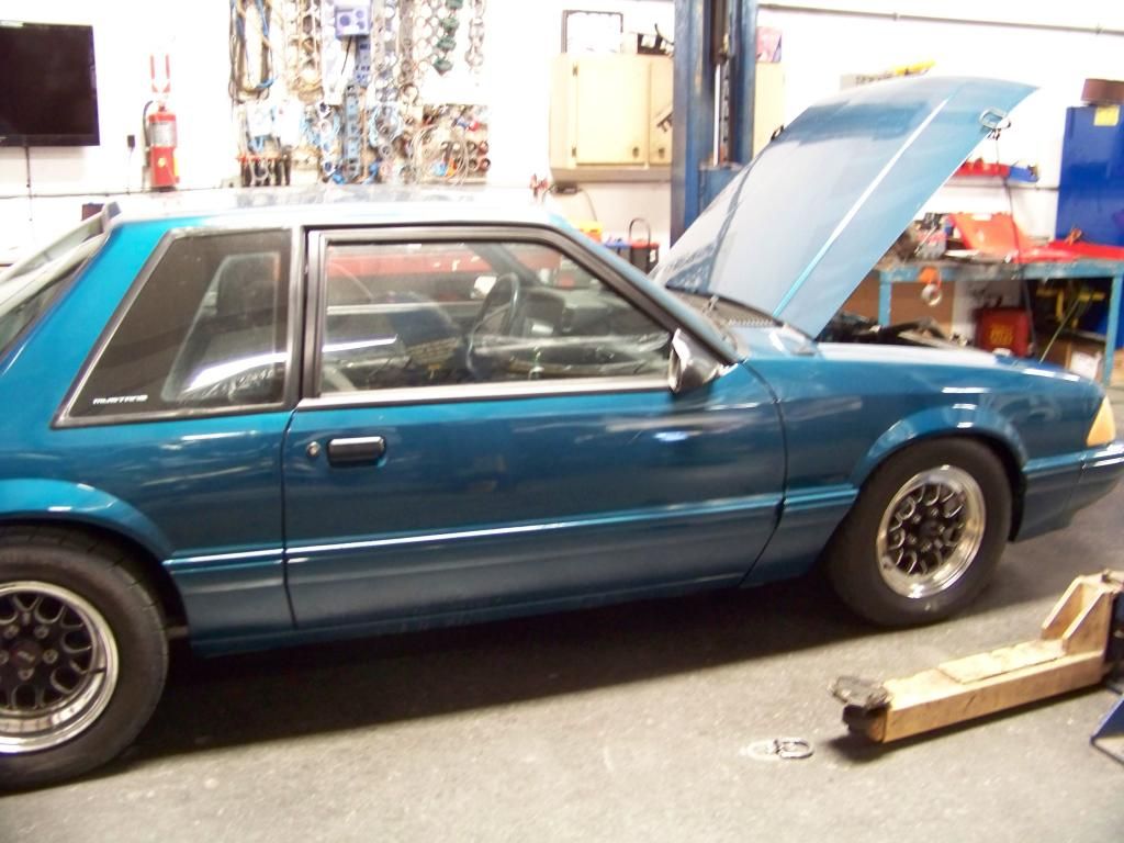

Well after just about finishing my 89 FHP coupe, 5.0 vortech S trim, 5 spd, 3:73's, Cobra intake, just bought all new a/c components, comp, cond, evap core and hoses and havn't charged it yet I've decided to do an LS1 car again. I miss my old one. What did it for me this time, I went to the track and the dam car is so heat sensitive due to the supercharger I had to wait to make frickn 3 passes due to a line of cars. Pass, wait to cool off, pass again wait till cool enough and just not fast enough for a power adder car. My LS1 car I could make pass after pass with no cool off period even with the a/c on. leave in drive, a/c on and run 7:40's with 235/60/15 tires.
My old LS1 car Super sleeper
only gauges in car, rest was factory gauges that all worked
under the hood with only one stage hooked up, later I had the second stage hooked up
and the car that is sacrificing itself to the LS1 demon Gods
93 Coupe, Reef Blue, a/c, 3:55's, 10 holes,
1/8 6.56 @ 103.23 mph, 1/4 10.37 @ 128.49 mph 1.43 6/06/15
1/8 Nos 6.06 @ 114.71 mph 1.38 12/16/15

well the past 2 weeks, been shopping, LS1 tech, ebay and amazon.
6.0 alum 30,000 shortblock
LS3 Brand new CNC and hand ported heads, flows over 325 at 600 lift
LS3 intake and injectors
Fast 92 T body
Z06 MAF
2000 Camaro wiring harness
Conversion pigtails from LS1 to LS3
Lingenfelter conversion box 58 wheel to work 24 reluctor wheel
Headers (Ford 351w converted to LS1)
Motor mounts and frame mounts
Custom Comp Cams grind for nitrous
Champ Oil pan and setup
New alt and starter
New coils and brackets
LS3 timing cover
Built turbo 350
ordering Nitrous convertor for LS1 flexpalte (no spacer needed)
New radiator
New 2000 Camaro dual fans
Corvette Filter with built in regulator and an fittings
o2 sensors
I'm sure I'm forgetting some stuff but man this was almost a full time job to find this stuff lol.
Motor should go in about 2 weeks and running in about 3 and then having Formatto tune it on the dyno
Hoping somewhere around 480-510 streetable hp.
Goal is 10's on motor and then 9's on nitrous, all with small tires and under the stock hood like the reef blue coupe thats pictured.
