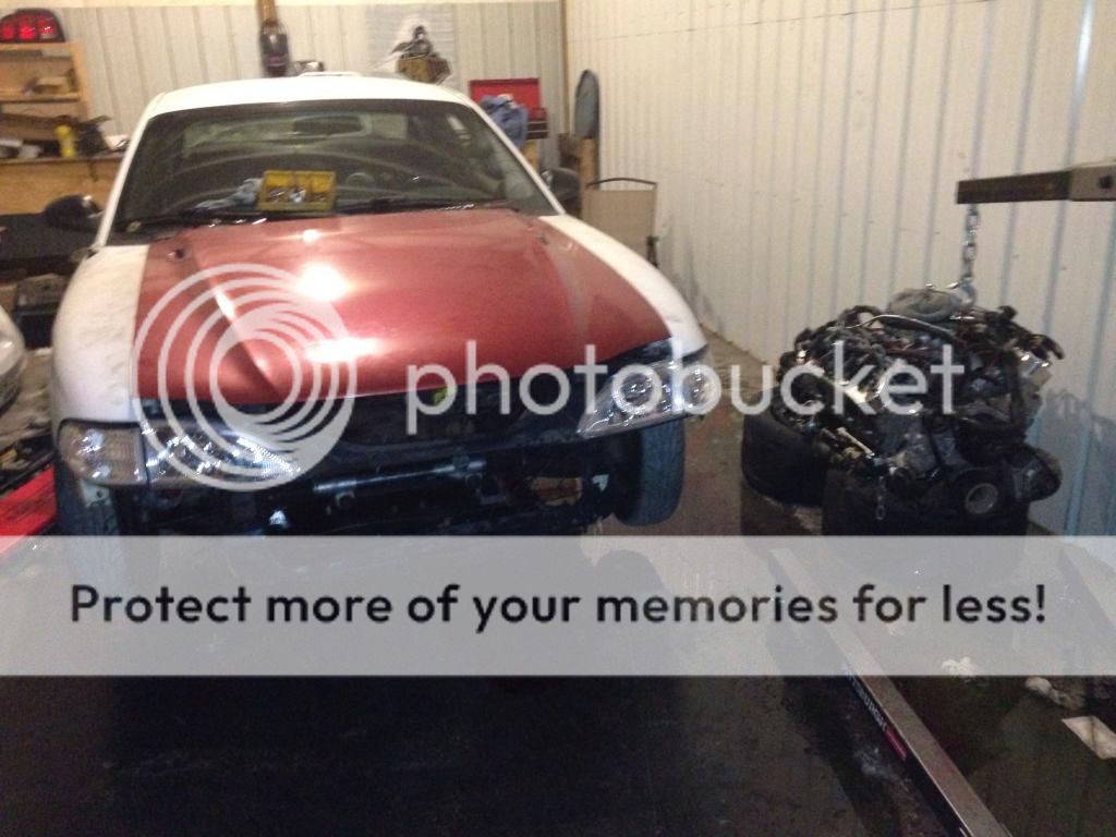

Car is a 1998 GT with cobra bumpers and an R hood.
Was a turbo 5.4/th400 car I bought as a roller.
"6pt" cage
Built rear with an ARB and a custom fuel tank
Coilovers in the front
PA racing tubular k
And some other parts
Got it delivered to the garage and got to work tearing it apart.
car was an oil disaster and packed full of modular wiring mess
wiring cleaned up for the most part, bay degreased, flaming river manual rack installed and the brakes halfway torn out
