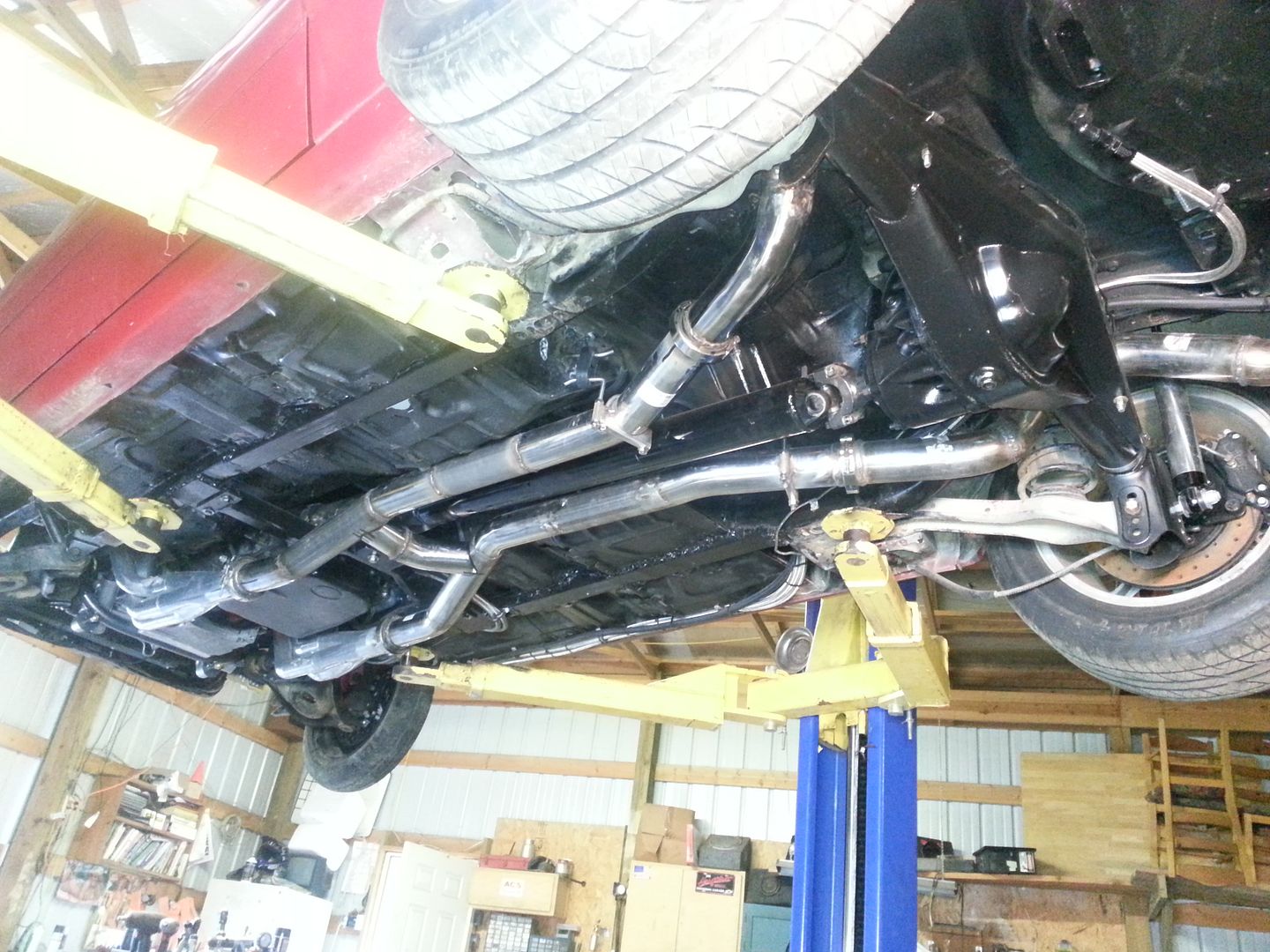

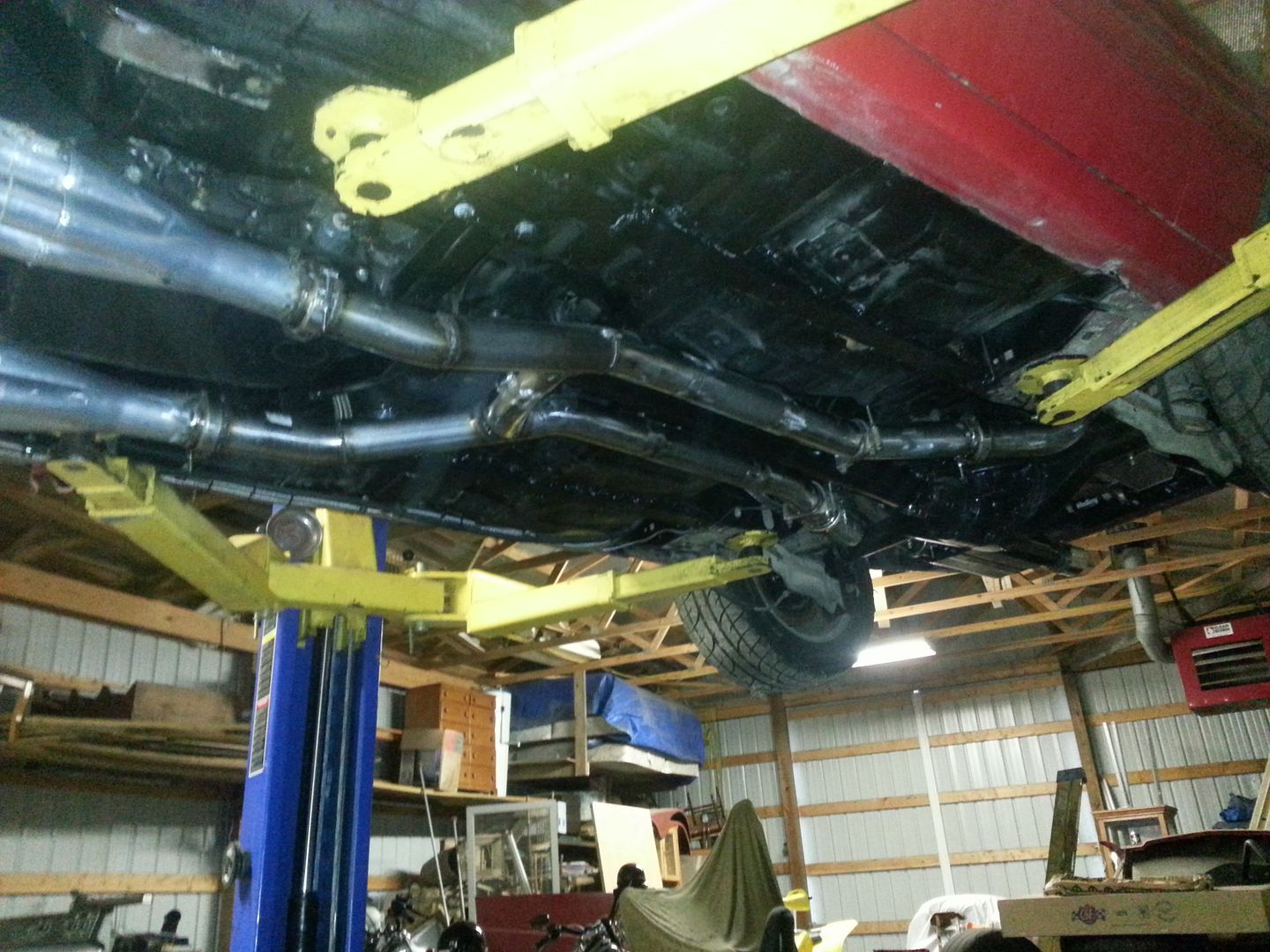

thought about trying to buy a premade foxbody exhaust and just modifying it to match up with my headers....
but after seeing a buddys exhaust on his 5.0 non swap fox...I decided to just make my own
my mufflers would have fit in the stock location...but I decided to put them at the rear since I have a fuel cell with a sump and no stock tank...
gave me more room to get 3" over the axle on each side.
-Scott
