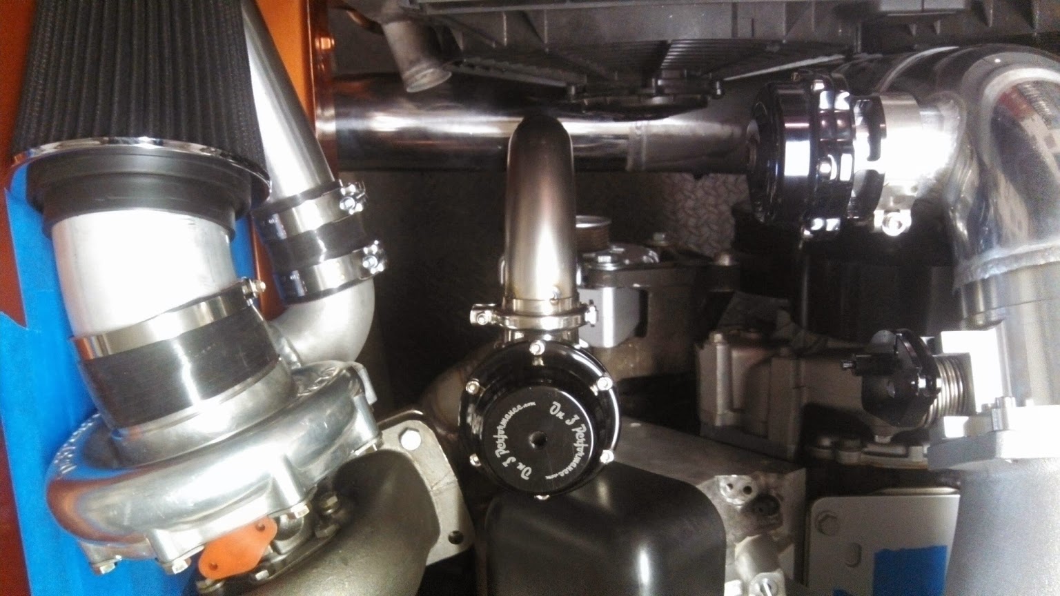

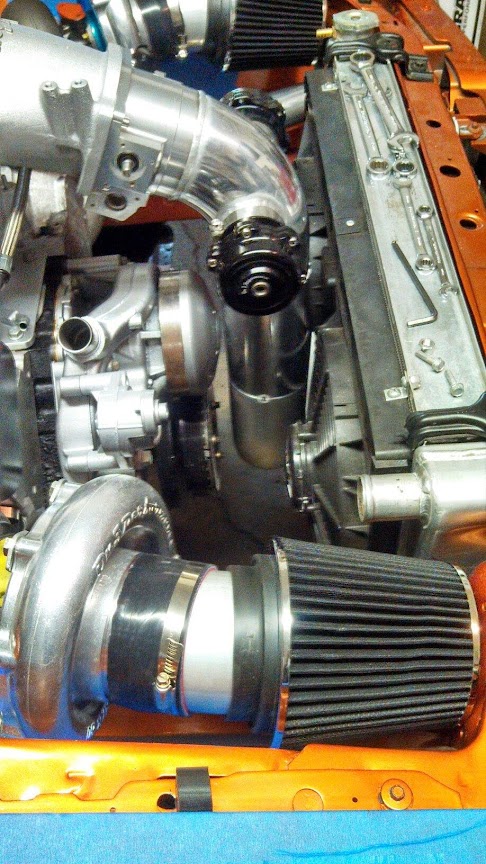

Some more progress. Gates are placed. Got driver side gate dump done. Got my Bradco 10" bolt together converter in so I mounted my BTE TH400 with RMVB and a brake. Used a AJE tranny crossmember and it all bolted right up. Started the driver side down pipe. Not too bad fit but will have to go on and off from the bottom. Exhaust will be straight through and run through a x-pipe right into polished straight tips rear exit. Also got a guy working on some new edge 5.0 style fender emblems but 6.0 instead. Should really confuse some people when done.

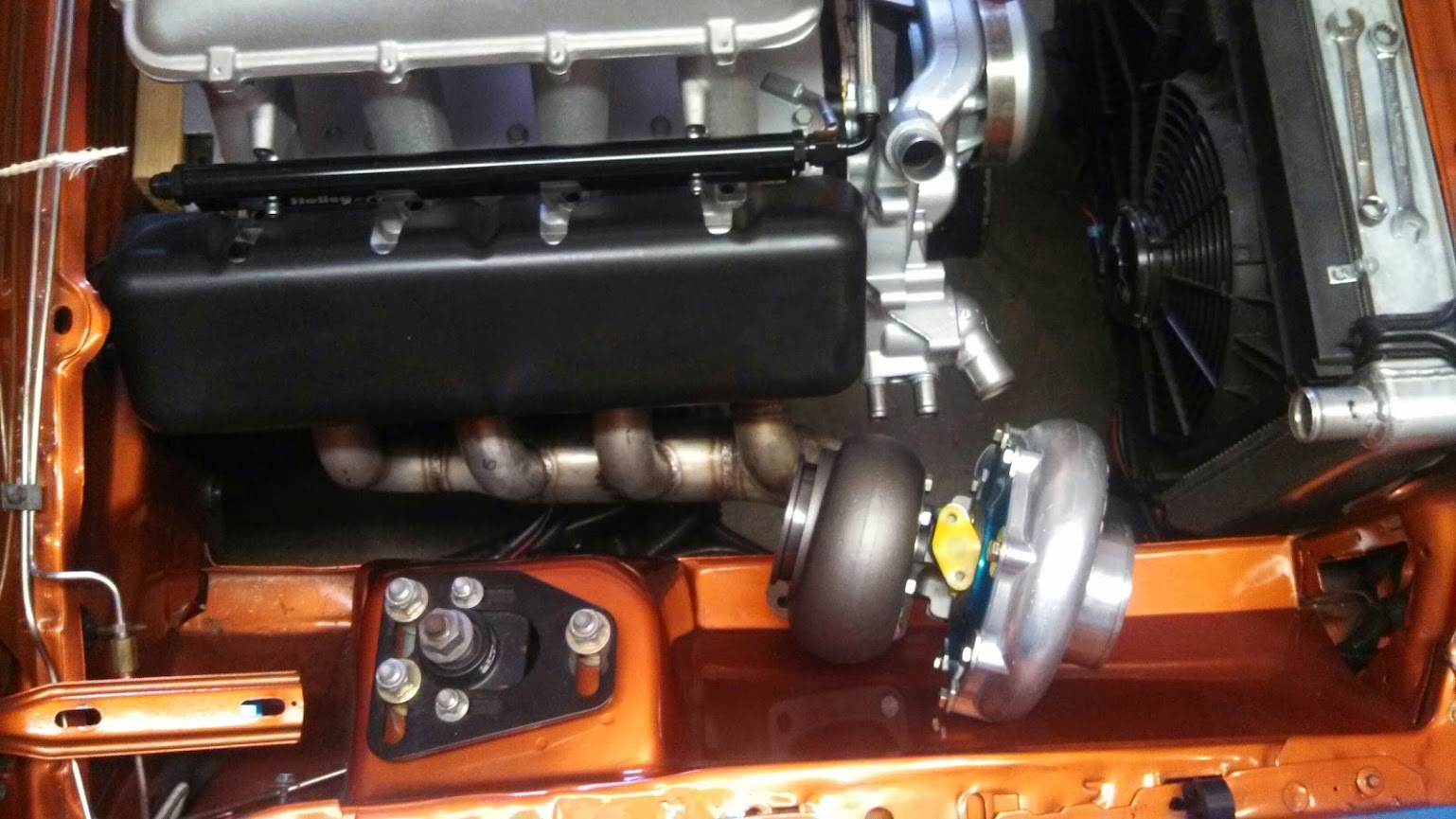

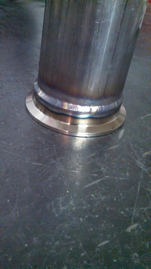

Passenger side down pipe. Had to go back toward firewall and then down as mustang k members sits motor offset a little for brakes and steering.

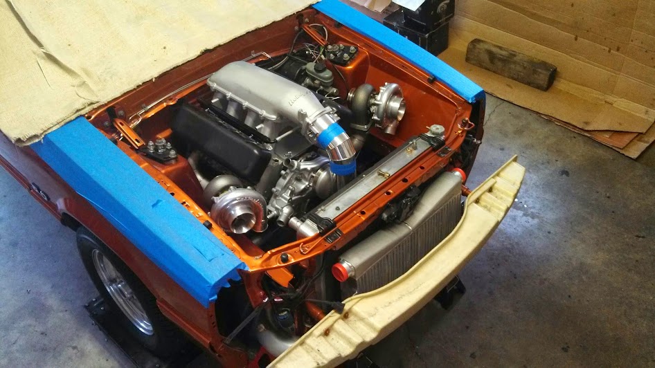

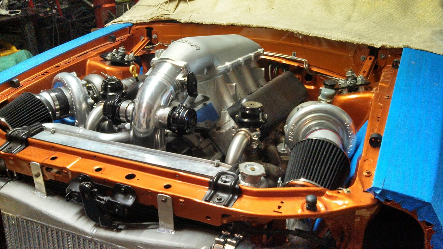

All fab work complete just finishing up the exhaust mid pipes. This is the engine bay before it goes in to paint for some more detail. Down pipes are double wrapped in black. And had these 6.0 badges made chrome and mirror black modeled after the new 5.0 design. Gonna have to see them on car before I decide which I will use.

post #23 of 89 Old 12-10-2013, 07:02 PM

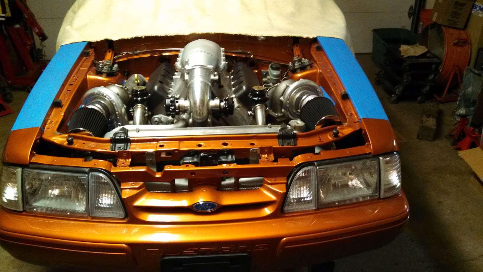

Fab work is done on the Notch. George and I have worked on and off for the last month. Mounted the Team Z wing today. Hood pin holes are drilled but body shop needs to fit hood. It will now be heading to our buddy for some paint work. From there it will come home to finish up wiring, oil lines, boost controller, shifter, and all the other little stuff it takes to get a car ready to run. The exhaust was made to resemble the traditional 5.0 exhaust and hooks up to 3" LX tailpipes. Mufflers are clamped for now as they may come off if I need more rumble. Not used to quiet turbo cars. Some stuff I didn't picture previous are magnafuel pro series 625 fuel pump(will be running E85) with 160lb injectors, bradco 10" 3500 stall converter, BTE TH400 with ultra bell.

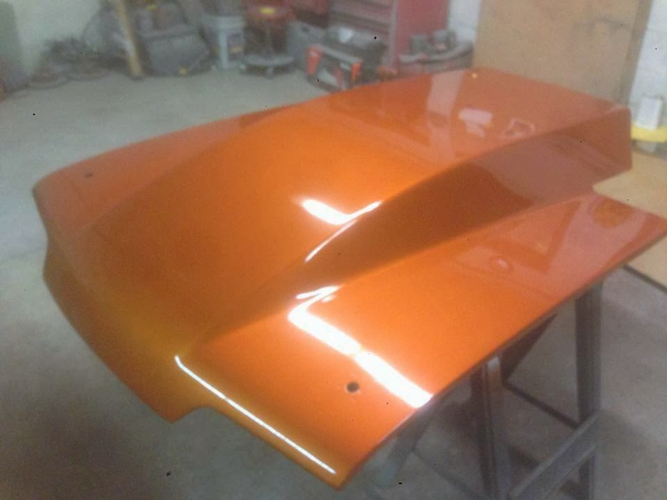

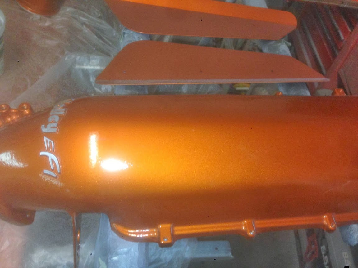

No updates in a while car at at my buddys paint shop getting new hood painted and fenders and bumper blended plus some speed holes in bumper to help with air flow to intercooler. Also wing and some under hood pieces being painted.

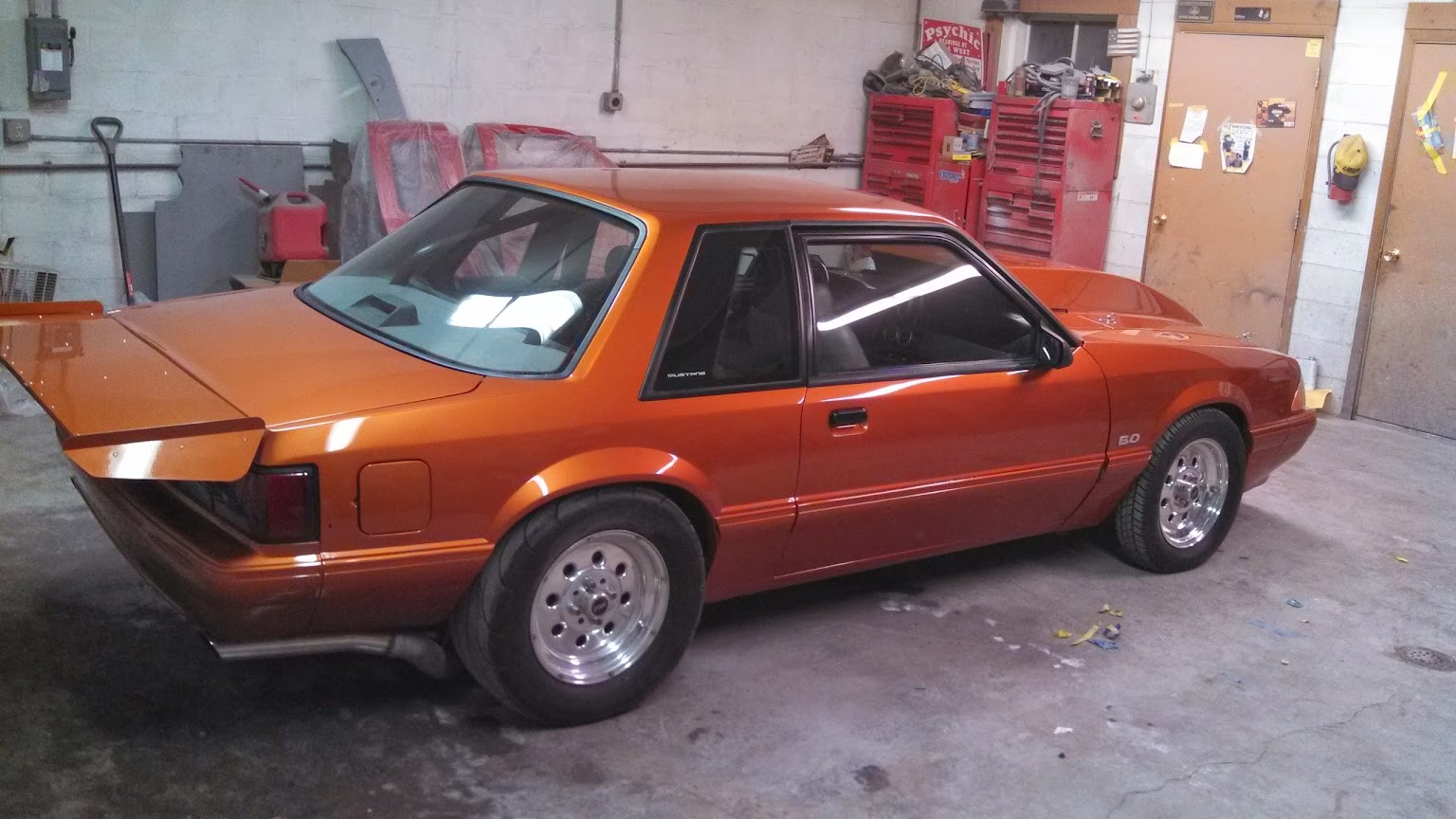

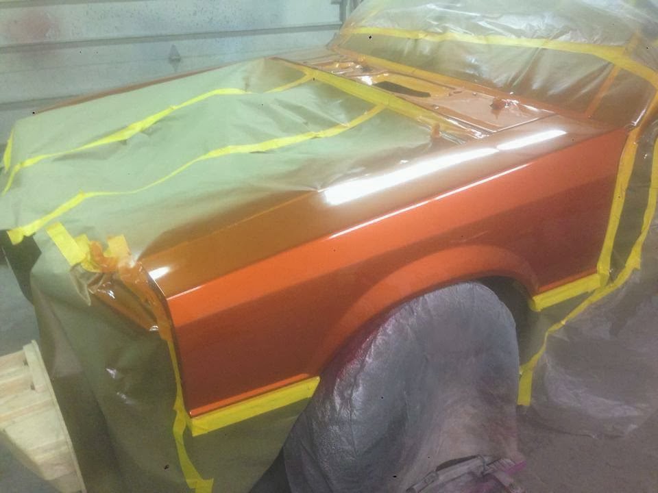

Picking car up from painter. Bumper is just thrown back on for transport needs aligned properly but fit and finish is great and the paint blended in very nicely.
