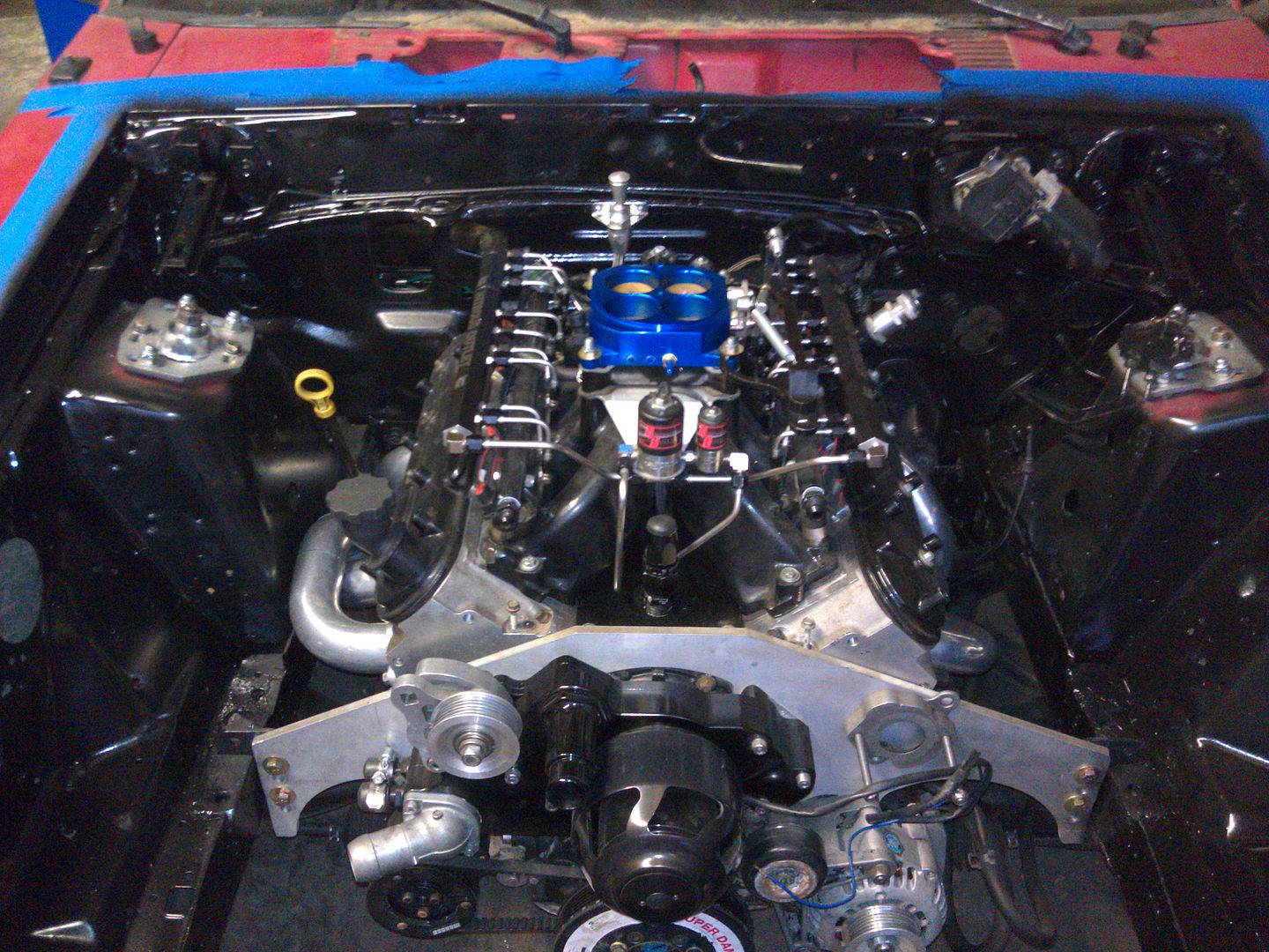

Anyone using one ?
Got mine in today and the truck oil pan hits like crazy and not close to lining up.
its actually rubbing where the sump arches back in to the shallow part of the pan, I know the sump of the truck pan may hang too low but im just mocking it up for now.
from the looks of the pics it looks like the sump of the car oil pan is not as deep in the sump area but still looks like it will hit where the sump "arches" back in to the shallow part of the pan.
any thoughts?
ill call team Z monday but trying to figure something out this weekend.

Dave actually emailed me this morning.
There is an issue with mine. He's sending me out a new one.
Good customer service for sure.

the motor is in the car, its a 5.3 from a 2000 silverado. nothing done to it just a set of injectors made to fit and some cleaning.
the oil pan clears with plenty of space but does hang low. Nothing worse than a set of longtubes id say.
ill have pictures as soon as i get home for everyone who needs them!

Mine is in too- few things were off but i guess its in and thats the important part.
the truck pan does sit low. Ive heard the car pan will not work with the current version and he may be re designing them- sucks for us that bought the first design who assumed a car pan would fit- should be some note on the site about the pan fitment in my opinion.
the lsx block plate to sbc mount had block to bolt interference and the block will have to be notched.
the motor didnt line up to the k member with the mounts installed on the block and torqued.
I had to loosen up the 4 plate to block bolts then put then engine mount bolt in and then re-tighten the block plate bolts- kind of a PITA.
the SBC mount is maybe 3/8 wider than the k member where the bolt goes thru but cinched down when i hammered it down with the impact gun.
im sure the 2nd version will be improved- after all we are not running windows 95 or have iphone 1's anymore right ?
rforres is offline

My first k member was replaced and the 2nd one clears the truck pan just fine.
there are a few more tweaks needed and I sent Dave the pics of the area's that could used to be tweaked.

I had the same problems.
the block needed notching so instead i threw about a inch of weld on the top of the plate.
the mounts needed to be unbolted from the other side just to match up then retightened.
also i made 1/4" spacers out of aluminum stock on a lathe to make up for that gap.
overall im impressed though

Originally Posted by TxFireman1972 View Post
Have any pictures? I'm having a hard time visualizing what you are talking about. Having a blonde moment I guess lol
the block has to be clearanced behind that missing bolt. (the top missing bolt) there is a casting rib on the block right there- took 5 minutes with a die grinder.
the bottom bolt in the pics thats missing fits fine- it was just missing in the pic
there is a decent gap between the mount and k member- mine squeezed together using an impact gun. who knows what it will be like when I remove it- you may want to just shim it with washers.
I had to loosen up the 4 bolts that hold the "plate" to the block to get the "mount" to line up with the k member then retighten.

I use the Fox K-member, and I use a modified Fbody Pan
no issues here...
I also have a 408, using 2" Heddman swap headers, and Motor plate and midplate so I could set the motor as low as humanly possible.
to give you an idea of how low the headers are..
What this equates to... is that truck pan will still be fine on the street...
and where mine sits in the car
-Scott
