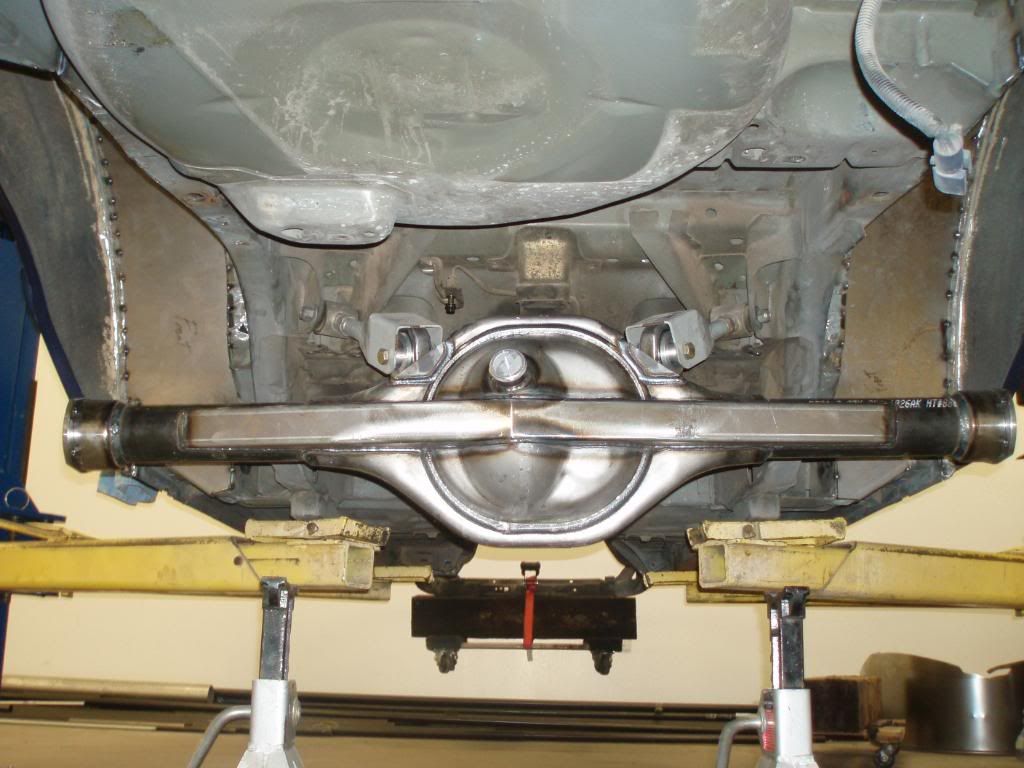

I got my housing and axles today and my wolf mini tubs (Sorry no pics. I'm not allowed for some reason) Tomorrow I'll start mocking up the housing mounts and cutting out for the tubs.

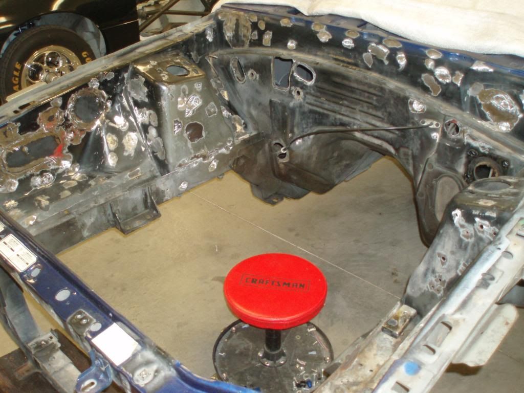

I also got of the engine bay holes filled... Just gotta sand eveything down for paint. And the engine is 95% complete. Two stages of nitrous. (Fogger and a plate) E/T LS7 style heads, GM carb style intake with a Wilson Elbow and a Jesel belt drive cam... It should look killer in the new engine bay when painted.

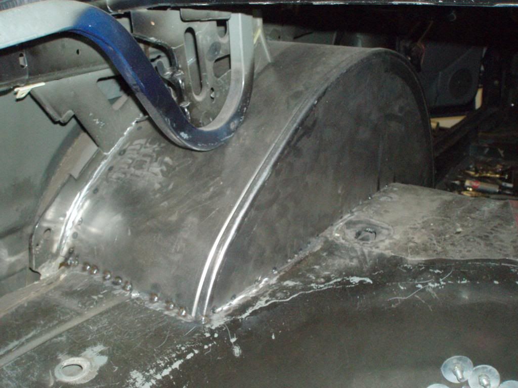

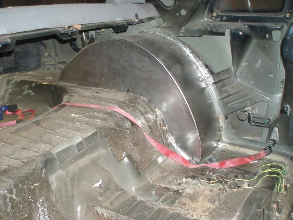

The Wolf mini tubs are almost in. (One side done) It's a lot easer to do than putting mini tubs in a F-body Gen IV car, that's for sure. I should have it all done by the Saturday night. Then I can start mocking up the housing mounts and see if 3.5" off each side will work well with a 12 rim and 5" back spacing.

Catching up on this project. The tubs are in and the housing is hanging from the upper mounts. I also tack welded the LCA brackets onto the housing and now I'm measuring everything up to make the lower control arms... I'll have plenty of room, even with 3.5" off each side.
I also mounted a set of 325's DR's on 10" rims that I had for another car. And with 5" of BS-ing, everything clears. I'll order up a 12" version of the same rim soon and it too will clear without a problem... The wheels look killer on the car (IMO) and I think the 12" will look even better. The car will sit low too.

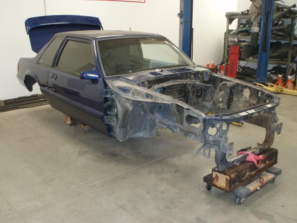

The 25.5 sub-frame connectors came in this week so I started cutting out the floor to mock that up... It's going pretty good, but it's a pain in the arse!
LS Coupe is offline

Change on plans on this project. I cut out all the floors and will be putting in a 25.2 cage instead of a 25.5. And I'll go back with a much nicer and cleaner looking floor and removable trans tunnel.

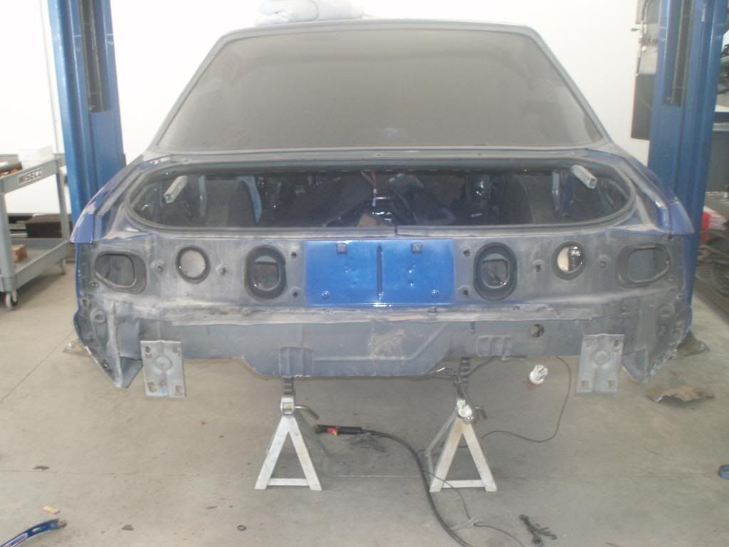

The cage is coming along( I'm on and off it right now) but still making progress.
The outer floor bars, A-pillar and roof bars are mocked up and I'm starting to mock-up the funny car cage section this week. I also got all of the front suspension bolted on... All RaceCraft stuff and it fits very well. Just need the brakes and that stuff will be done.
I still have to make the motor plate and mid-plate... But I'll do that when the cage is done. (I need all the floor bars in first)... So I can make the tranny mount off the inboard rails. I'm trying to finish the cage by the end of the month so I can start mounting the engine and place all the plumbing crap. (Radiator, hoses, brake lines, dry-sump system, fuel lines, ect)

I'm back on this project. The cage should be done by the end of next week. And it should be a roller by then too. Then I'll start the engine mock-up for the motor plate(s).

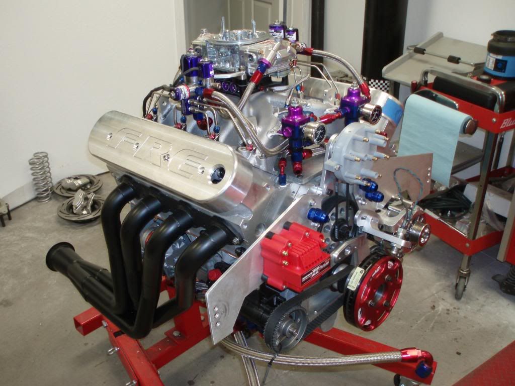

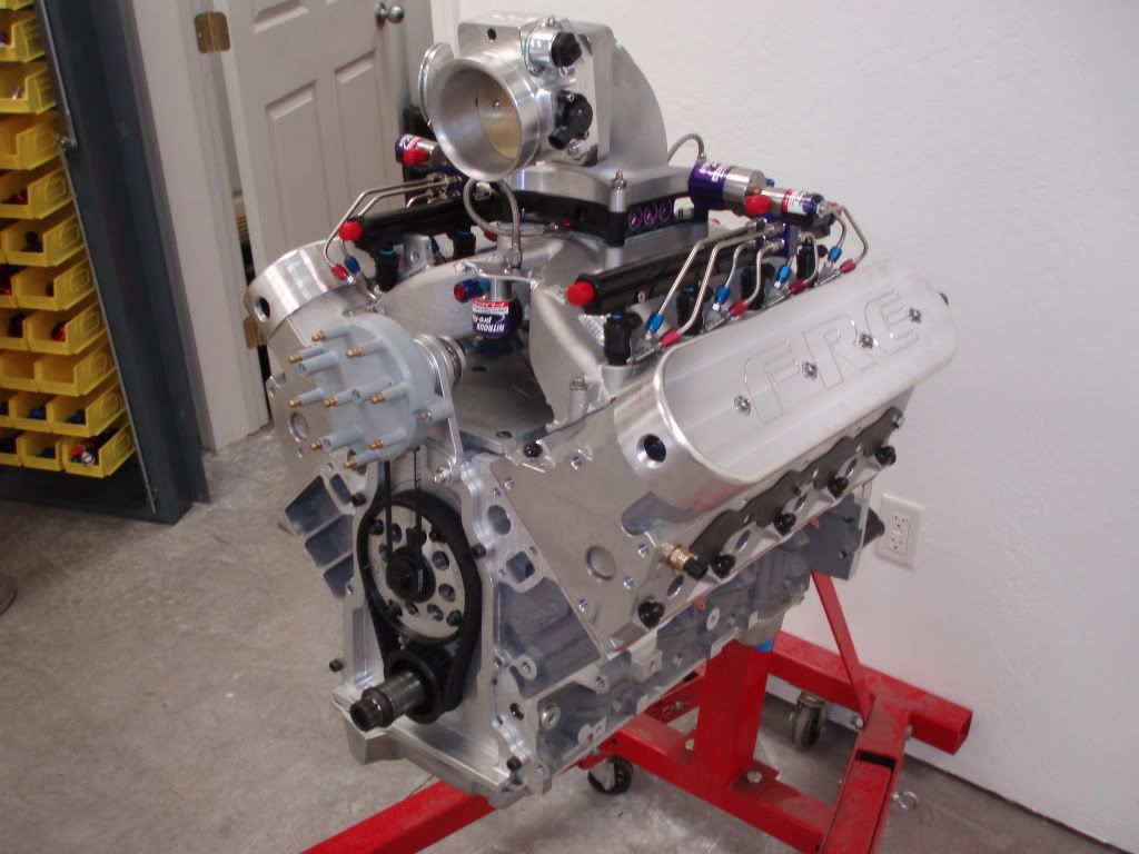

Thanks! Here it is pretty much ready to install back in the car. Just waiting on the car to get back from the paint shot.

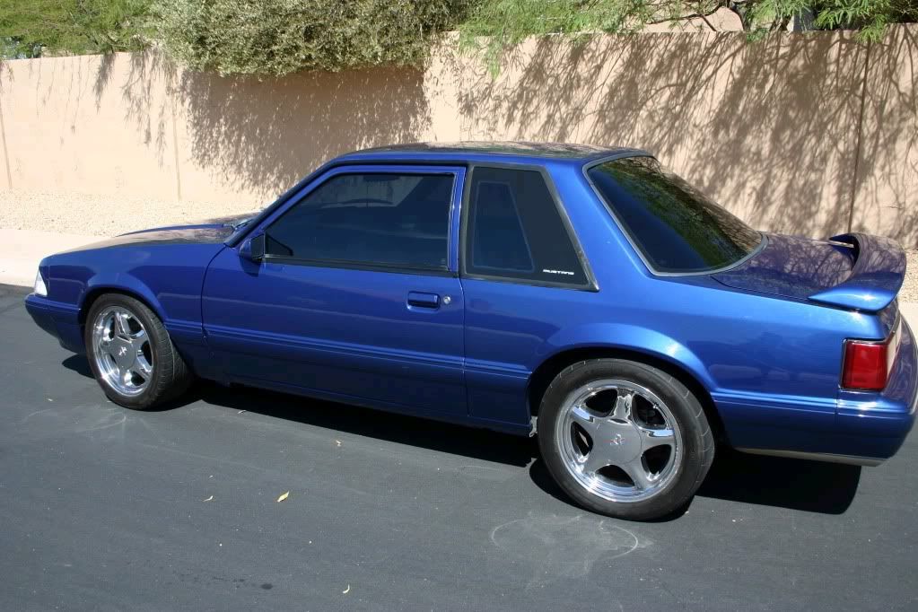

^^^Thanks^^^ And I guess I should update this thing because it's almost done... I'm finishing up the wiring as we speak.
LS Coupe is offline
