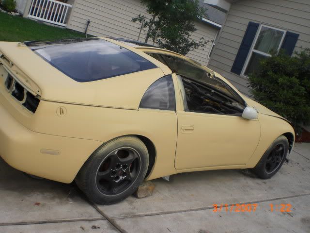

http://i113.photobucket.com/albums/n...8/CIMG2150.jpg
I hope this works it's my 1st time posting pics just a couple of the pics I thought were relevant, my body work and prime stage along with the 5.0 in it's final home. I have all of my paint to shoot the car I will do it myself and keep cost down b/c thts what it's all about.I still have to re route my fuel lines but thats not a real problem I just don't want it to look thrown together or(ghetto) I'm doing the 3g alternator upgrade 130 amp. thats why it's not in the pic, but it's all together I will get the 100% finish pics up shortly

Looks pretty good, hope your gonna do something about the over spray on those tires though.
