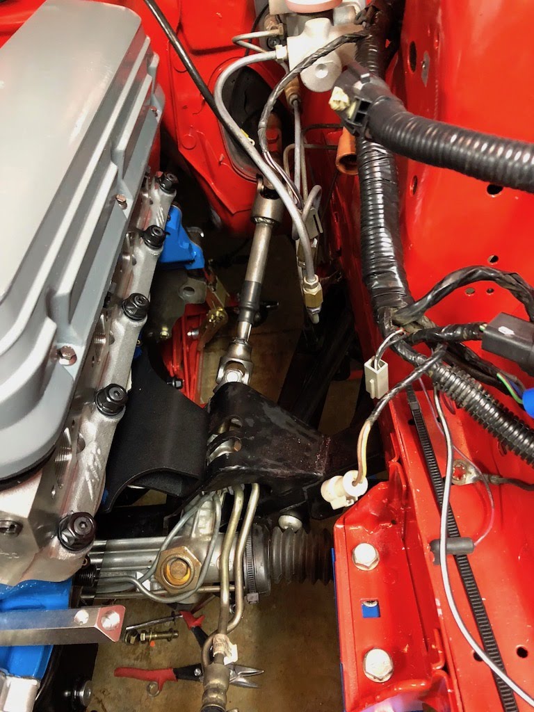

I finally go the transmission in the car on Friday night I ended up just tightening down the C-clamp I had on the clutch fork and it slid the rest of the way into the car. Hopefully I don't have to do that again for a long time. Should be easier next time now I know what to do to make it fit.
I also go the steering rack and shaft installed in the car. I had to put it in the middle holes of my MM steering rack bushings so it would clear the oil pan. So I will have to adjust the bump steer in the car.

I got more work done on the car last night I did some work on the placement of the motor. When I first installed the motor it seemed like it was sitting a bit higher and further forward then it did before. I decided since it wouldn't take me long to swap the MM solid motor mounts for the old solid motor mounts to see if I was right. The old motor mounts moved the engine back a 1/4 and down about the same. that was nice since it gave me better clearance between the K-member and the oil pan.
Its hard to tell from the picture but there is more clearance then it looks. I was really happy with that since I was kind of worried about it. So I figured I would just leave them installed and not use the MM solid motor mounts. I decided on moving on to finishing up the transmission install on the car. I got all the mounts installed and went to lower the transmission to find I have another issue.
It sits about a 1/2 inch off the transmission cross member. I would have to put a spacer between the trans cross member and trans mount to get it to work. The one drawback is now the driveshaft won't go into the car since the tail housing is so close to the transmission tunnel. The driveshaft is a left over from when the car was an auto it has the big dampener on the end. The other thing i causes is the motor to tilt back and I loose the gap I had between oil pan and K-member.
So now I'm starting to look at my options to solve the problem. I've come up with 3 options all ranging from mild to wild.
1. Leave the motor where it sits make spacers for the transmission mount to lift the tail of it up so the oil pan doesn't hit the K-member and get a new driveshaft that doesn't have the dampener on the end of it. This should work but not sure if I still won't have issues with the drive shaft and the transmission tunnel.
2. Really the same as above but add these to the car which should move the trans closer to the mount. It might also keep me from having to get a driveshaft but in the end I might just get one anyway.
K-Member Spacer Kit, 1/4" thick
3. This option is the craziest one of the them all. It could open the door for allot more custom work on the car which could add delays to getting it running. Taking what I was going to do in options 1 and 2 to the next level moving the motor back an inch in the car. This would give me allot of clearance between the pan and the K-member but could open the door to allot more problems. I looked at all the places where there could be potential issues with clearance. I looked at the steering rack to pan clearance which looks good its hard to tell from the photo below but there would be about 1/4 inch of clearance if the motor was set back.
The shifter opening would be fine and adding the spacers would give me more clearance between the transmission and the trans tunnel. I still have to look into all the potential issues that could come from moving the engine back. I'm going to take a look at it more tonight. I have a mental list of issues this could cause problems from easy to fix things to going to take some fab work. I read over the MM K-member instructions for the 1 inch setback on the motor and the only thing I haven't checked is the exhaust clearance with the firewall. I was going to put the headers on tonight to see what issues I might have with them hitting the firewall. Setting the motor back an inch was something I wanted to do but changed my mind now I thinking since I already have the car apart and I'm thinking about replacing the driveshaft anyway might as well take the time now.
What do you guys think of my potential solutions to the problem? If anyone has suggestions let me know.

I think you're over thinking things, and also ignoring something important (at least I didn't see you mention it)
Number one thing i'd take into consideration is driveline angles. Raising the transmission up by an inch will add more than a few degrees. If the mounts are that far out of alignment supposedly, then everything comes into question.
When you installed the motor mounts, did you tighten the nuts down before lowering the trans down? If you did, I would loosen them up, let the trans droop to the cross member, look at your angles and see how everything sits. More than likely the mounts aren't settled in the perches. You may be able to get the transmission mount started, then go back up front and snug the nuts down.

I did forget to mention it I have to look at pinion angle on the car to make sure its not getting out of control. The hard part is I can't lower the engine anymore on the engine mounts more then it already is right now or I won't clear the steering rack on the car. So I need to figure out a way to close the gap to the trans mount. By adding the 1/4 spacer between the K-member and the chassis it should lower the drivetrain to come closer to the trans mount.
When I installed the motor mounts I left the bolts loose on the motor mount to block so they could move it around. Then before installing the nuts to secure the mounts to the k-member I made sure they were fully seated in the slots. The transmission mount wasnít installed yet in the car when I installed the motor mounts. The problem is I canít loosen the motor mount bolts to droop the transmission to meet the mount since it will cause the oil pan to hit the K-member. If I move the engine back I can get allot more clearance to the K-member and have more options on making it work.
What I canít figure out is why the motor sits so high up that there is this big gap between the trans mount and the transmission. Not sure if its something with the Dart blocks since Iím using the same motor mounts and K-member.

So last night I decided to follow your advice thenemesis and make sure I was't over thinking it and double checked everything. I found everything was seated right and the root cause for the transmission not sitting on the trans cross member was the oil pan hitting the K-member. It was holding it up in the air. So decided screw it I'm going to set the engine back an inch and see what happens. So I decided to make sure a couple of things would still fit if I moved the engine back namely the headers only to find they were going to be a problem if I left the motor in the stock position. The header on the driver side was hitting the MM steering shaft. So I pulled the old mounts of the motor put the MM ones back on and moved the motor back an inch.
Which gave me a ton of oil pan clearance.
I have plenty of clearance from the K-member to the steering rack.
Once I had the engine set back the transmission went into place fine.
After I had the motor setback I decided to check the header clearance on the driver and passenger side and moving the engine back an inch fixed the issue I was having with the driver side header. Then I checked to make sure the upper intake cleared the hood fine.
Here's how much clearance I have to firewall.
So moving the engine back fixed all the problems I was having with the motor fitting in the car plus it fixed one I didn't know I had yet. Now I can move on to the next issue I'm going to run into my guess its going to be the exhaust namely the X-pipe I might have to get that sooner then later.

I knew something had to be amiss. You're basically talking a cantilever with the trans sitting up like that. The weight had to be supported somewhere. Those little motor mount's were in no way going to support 500lbs of leverage haha.
Love the intake/VC color choice. It's a very clean look to have under the hood. But you have a mile of clearance now. I'm not looking forward to the day of screwing around with the oil pan clearance like this.. it's going to be a pain. Hopefully my motor gives me zero reason to pull it for a few years.

Then I worked on getting the rest of the sensors on the lower intake sealed so I could install the injectors and fuel rail. I also replaced the fuel pressure regulator
Then I started on getting the accessories installed in the car starting with the power steering pump.
The bracket for the power steering pump was looking really bad so I took some scotch bright pads to it and it cleaned up nice. I was going to take the my old accessory bracket and paint it black since it was looking pretty rough but with how nice the power steering pump came out I decided to do the same thing to it.
Then worked on getting the smog pump mounted.
I should have got a better picture of the bracket after I was done cleaning it but got to excited to get in on the car and forgot. Making some good progress on the car. I ordered the X-pipe for the car and a 3G alternator since the one I had in the car had a bad bearing in it I had just forgot about it. I think the next part is going to be getting the all the old gas out of the tank it smells like varnish. I have a new tank for the car to replace the old one.

I'm starting to work on the part of the build I don't feel like installing on the car the smog equipment. I have all the parts I need to get the smog stuff working again. I had bought it on ebay almost a year ago and it just been sitting around.
I also bought a new smog tube for the car all the ones I saw on ebay were in poor condition so I decided to buy a new one.
It fun trying to get it installed with the motor set back. The flanges on it are so tall you have to run a really long bolt to get them mounted which wouldn't fit between the firewall and the motor. So I had to unbolt the transmission mount and jack the transmission up to get enough clearance to thread the bolts in.
I also go the sway bar installed in the car.
The things i didn't take pictures of because I forgot is took part of the dash apart so I could get the speedometer cable disconnected from the gauges. When I was racing the car before at one point the speedometer stopped working so I disconnected it since it was making a funny noise. At the time I really didn't care about it working for me I didn't really need it. I could figure out about how fats I was going based on engine RPM and the gear I was in to figure out my speed. So when I pulled the transmission I found the speedometer gear was completely destroyed and the cable wouldn't turn at all. So I picked up a new cable and gear for the car I'm just waiting on the cable right now.
I'm also taking a look at what I might do about the 10 pin connectors on the EEC harness. I have thought about just connecting the two together using non-insulated butt splice connectors and double walled adhesive heat shrink tubing to get rid of any connectors. I also thought about going the Deutsch connector route or just leaving the 10 pin. The injector harness on my car is new the old one was in rough shape so I decided to get rid if it. I could just clean up the main harness connectors make sure there making good contact and call it a day. All the tabs on mine are still in good shape so they lock together really good.
I'm hoping to make some good progress on the car this week. I'm going to have a pretty open Saturday and Sunday this coming weekend so I should be able to get allot done. I need to get the drive shaft length checked and get the old gas out of the tank so I can pull it and replace the tank with the new one.
