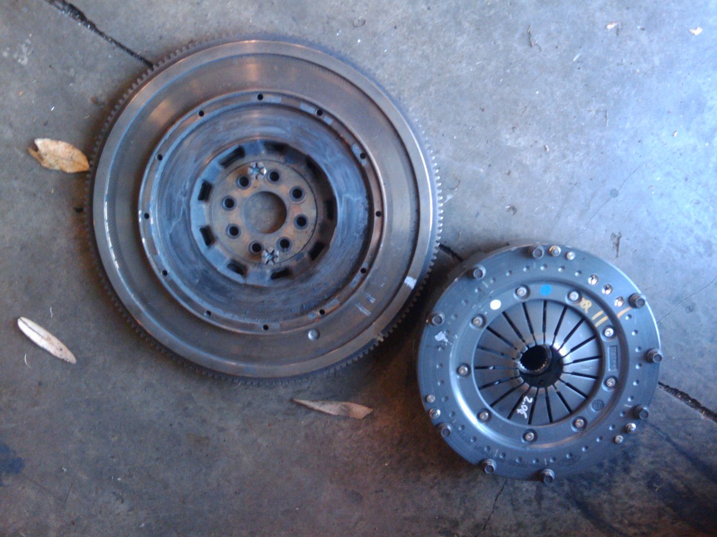

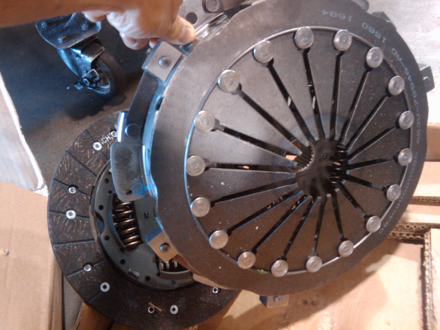

both are dual disc setups...the revised being much bigger in circumference with more surface disc area..
this is the old setup:
and here the new revised setup:
