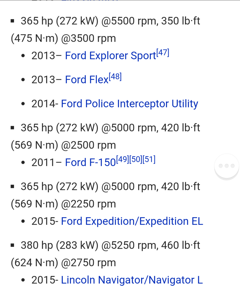

are all the ecoboost v6s from F150s?
my brother has a Taurus SHO with the same thing and my Explorer Sport has it too.

The SHO version is for transverse mounting so it has a different block, different turbos, etc.
I guess the explorer sport version is the same, isnt it?
If they're similar output, probably close. F150 coyote is different intake cam from the Mustang and not much else. But the main difference Hidley pointed out between f150 and taurus evoboost is transverse vs longitudinal. Ford had different packaging concerns.
There's clear torque differences, not sure if pistons or other major stuff is different. Where's our Ford techs and junkyard regulars?
Since wikipedia is such a reputable source:
B0jangles is offline
post #32 of 50 Old 03-20-2016, 01:43 PM
Join Date: Apr 2003
Location: Utah
Posts: 5,967
Difference is turbos. Taurus and Explorer have GT15s and F150 has slightly smaller K03s
