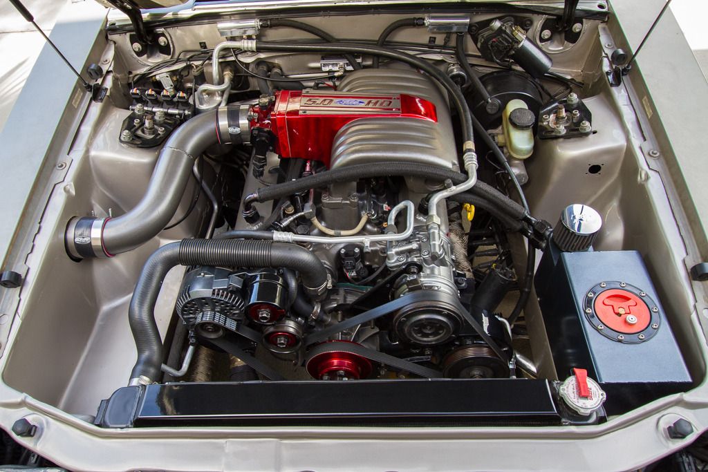

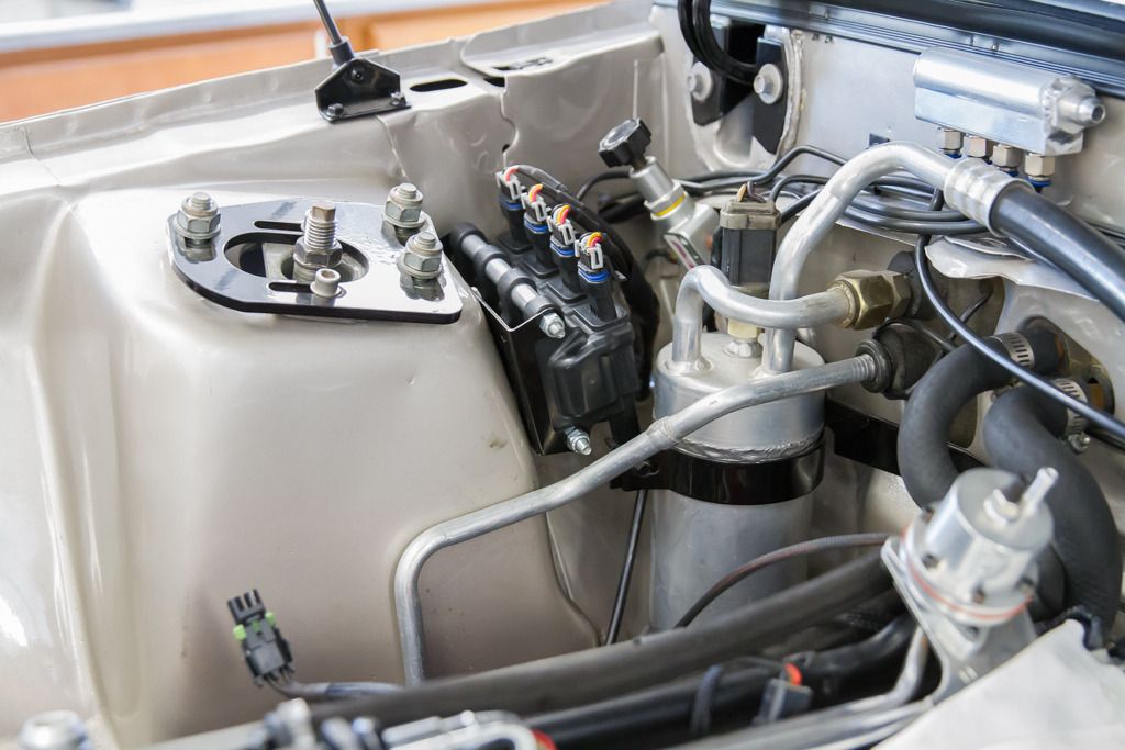

that's a nice engine bay!
can you post some close up pics of the coil setup/mounting?
Thanks. I got the coil holders off of ebay, and then welded a couple pieces to them, to mount them to the K member. I would have done the same thing on the passenger's side, but I have my down pipe running through that part of the K member, so I mounted them behind the shock tower. Whenever I build my next setup, they will be getting moved down though.
