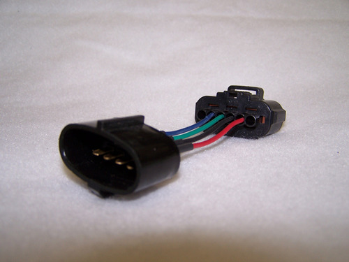

I have a 1989 Mustang GT with 4-pin MAF connector. I bought an SCT BA3000 MAF that has a 6-pin connector. I think the adapter I need is SCT 2901. After researching SCT 2901 on the internet, I see pictures that show a short wiring harness adapter and pictures that show just a plastic adapter without wires.
Question: Does it have a short wiring harness or not?

Mine had a long harness.. the length of the harness is irrelevant. All you need is to go from 4 to 6 pin..
Personally, I'd forget the adapter because they are known to be problematic, and just solder in the pigtail, cutting off the factory plug and using the new plug on one side..

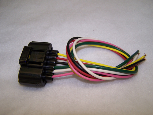

Splicing PMAS 6-wire Pigtail into 1989 4-wire MAF Harness
I spliced the PMAS 6-pin MAF wire pigtail (PIG-X) into my car's MAF 4-wire harness. The wire colors for the PMAS pigtail were different than the pictures shown in the earlier posts above. The picture below shows how I ended up splicing the wires and I also added my notes to a MAF wire diagram I found online.
