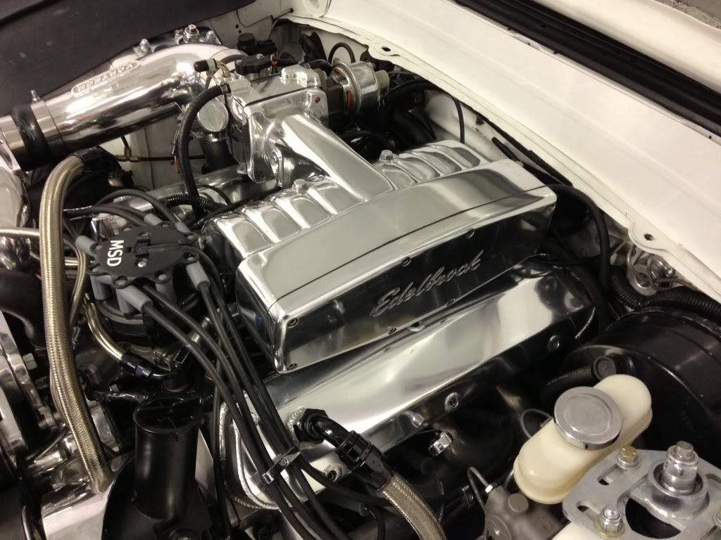

The car. Dart 347/ TFS 205 CNC heads/ Kurgan custom cam/ e85

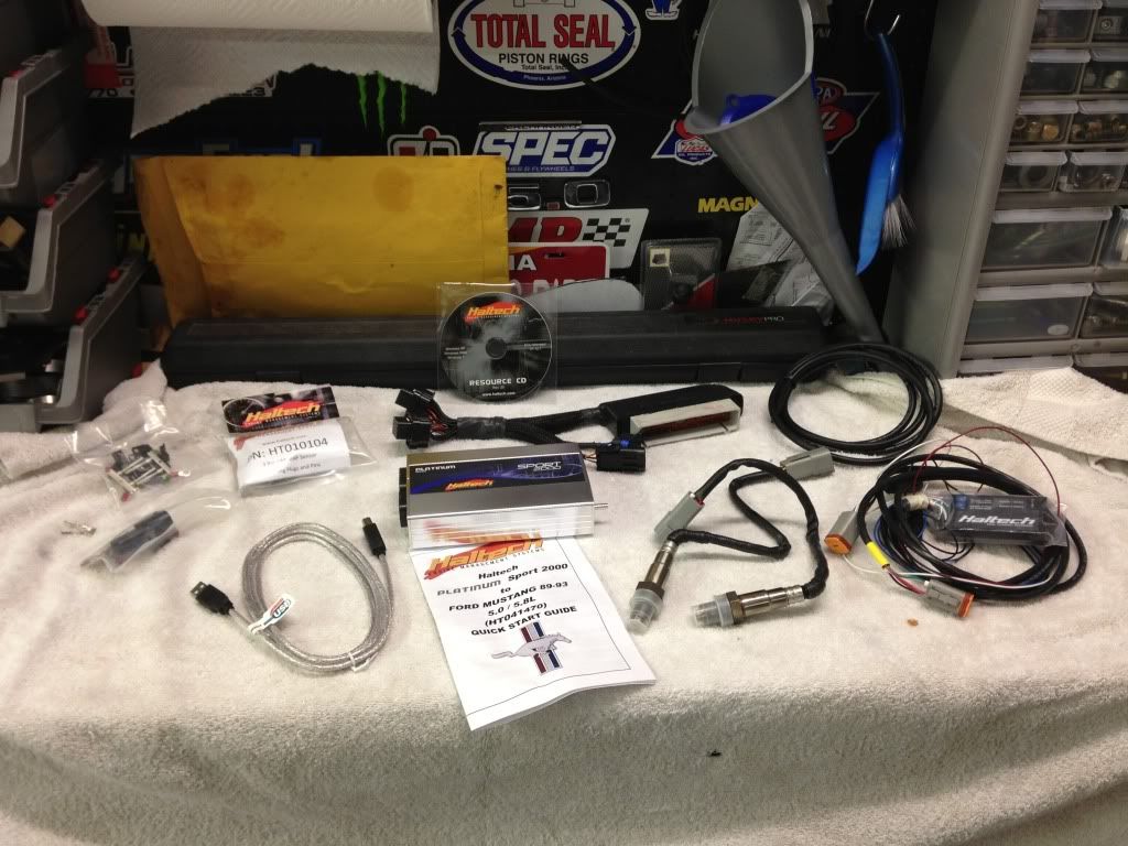

I put my order in for the Haltech Platinum Sport 2000 ECU and patch harness for Fox Mustangs. This is Haltech's flagship ECU and has been used on mild street cars all the way up to mega hp race cars. The base kit includes the ECU and a Haltech-made patch harness that simply connects to the stock ECU harness and then to the Haltech ECU.

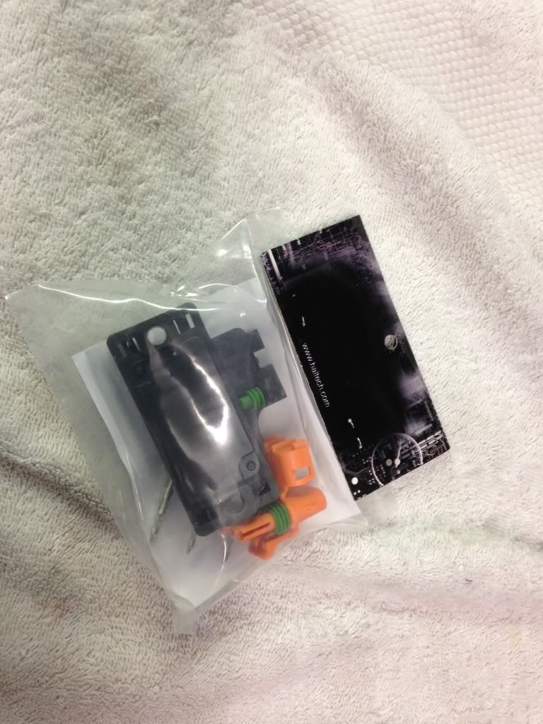

I also opted for the highly-recommended dual wide band kit and a 3-bar GM MAP sensor. The Haltech ECU has an internal MAP sensor that is good for up to around 20 psi, so most can get away without an optional MAP.
Here is what I received...

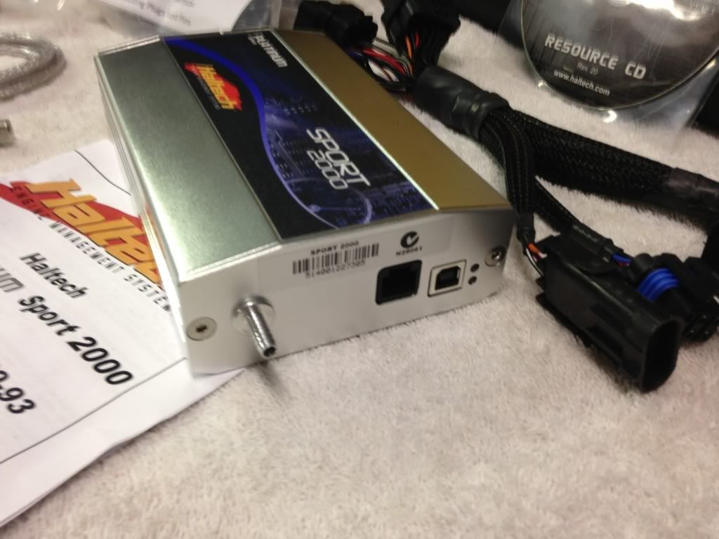

Internal MAP sensor vacuum port and communication port for lap top tuning

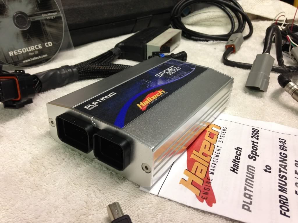

Harness connectors for ECU
Patch harness for ECU
Haltech wide band o2's

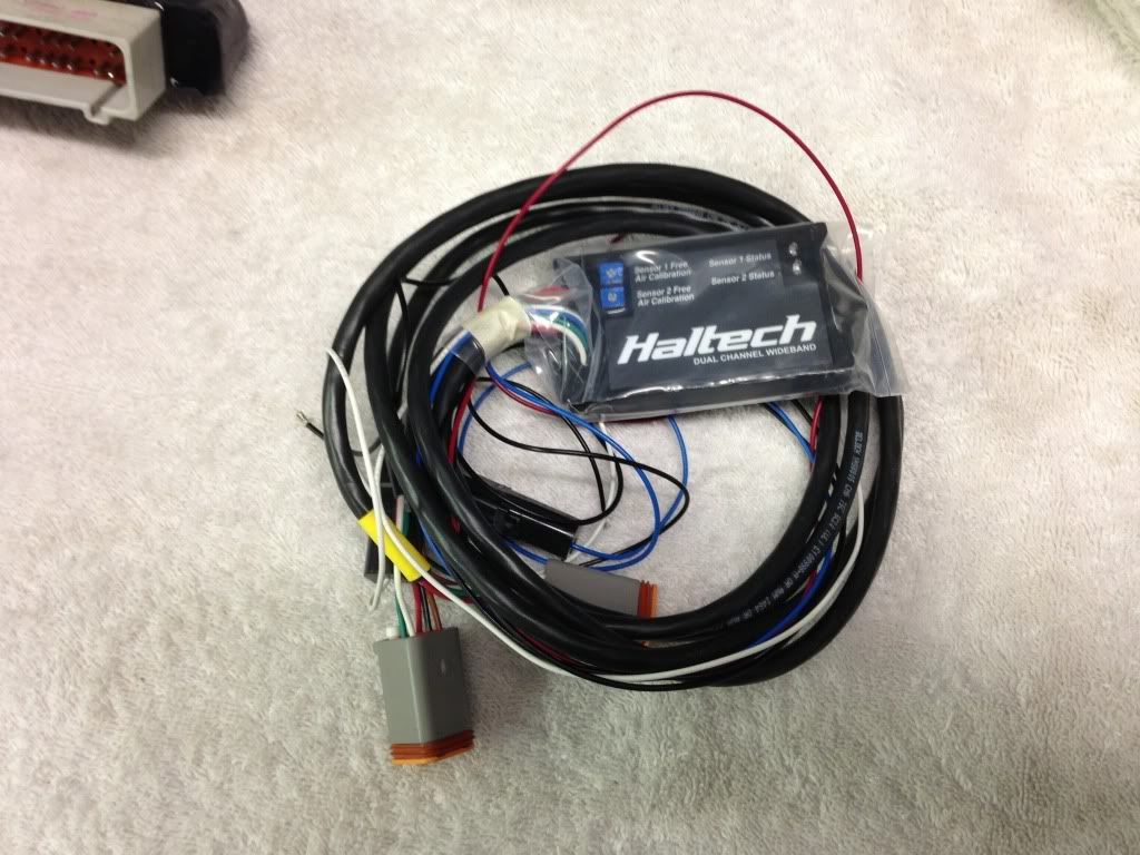

Wide band o2 controller

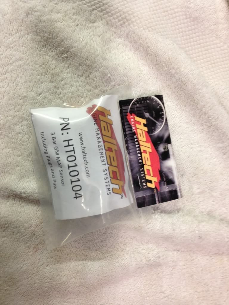

Haltech GM 3 bar MAP sensor

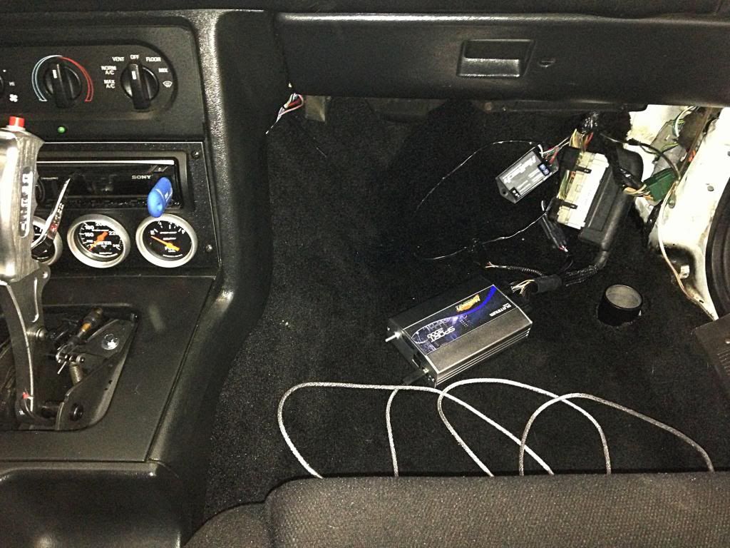

Plug the ECU into the stock harness. Takes 5 minutes. You do need to run a vacuum line to the ECU if not running an optional MAP sensor, but that's another 10 minutes...
Communication cable and o2 controller also shown. A bonus is that the Haltech ECU and harness will tuck away into the foot well like stock and the kick panel can be put back on.

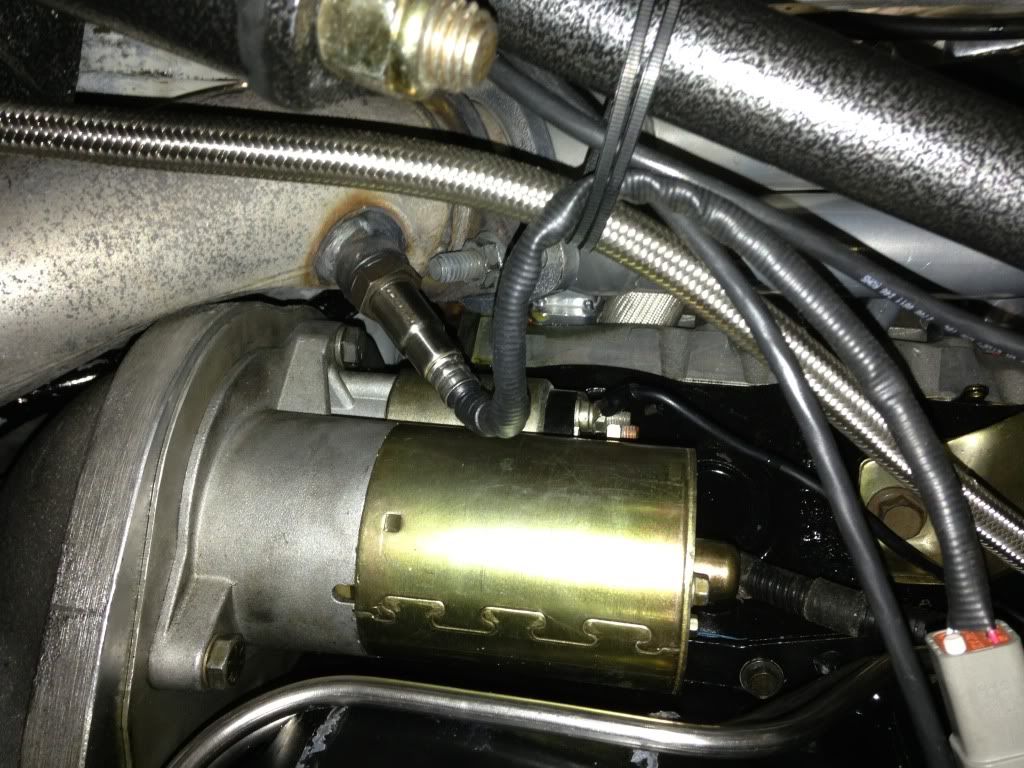

The wide band 02's are a snap. You won't need the stock 02's, so simply put them where the stock ones were.

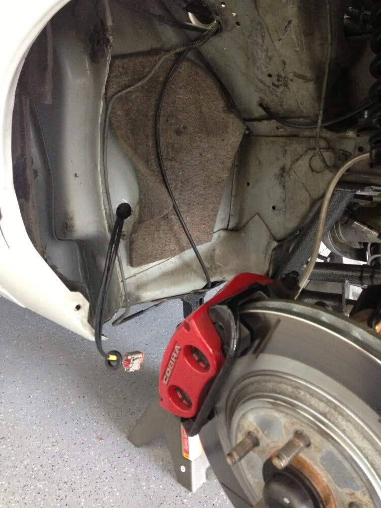

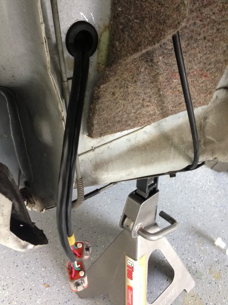

I cut a hole in the pass side fender well, leading to the foot well near the ECU so the o2 wires could reach the ECU.
Rubber grommet installed and voila
Each o2 simply plugs into the wide band controller and then the wide band controller plugs into an extra connector provided on the patch harness for the Haltech. Super easy!

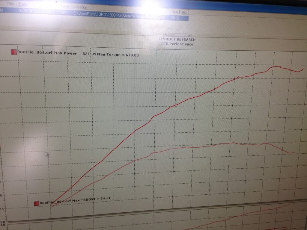

Once you get the base map, throw it on the dyno and tune it. Bob Kurgan happened to be coming out to So Cal so he worked his magic with the Haltech. Granted, this was the first time he had ever used the system, and we got some great numbers...
First of all, there's no back-to-back dyno numbers for one good reason. I switched from a 5 speed with the stock ECU, to a Freddy Brown AOD with a 4500 stall unlocked converter with the Haltech. Bob told me that from the hundreds of cars he's tuned, in his experience an unlocked auto like mine will lose anywhere from 100-120 rwhp. I made 858 rwhp through a 5 speed. Bob told me up front that he expected to make 750 rwhp at best with the Haltech through the auto. I made no other changes besides the transmission and ECU.
Bob was pretty impressed (and if you know him, that's hard to do, lol) with the numbers we made with the Haltech. With NO changes other than the transmission, we belted out 821 rwhp through an unlocked auto! Damn close to my 5 speed numbers with an expected loss of 100-120 rwhp versus a manual. So by our best estimation, the Haltech alone gained from 60-80 rwhp. That's a huge increase. We had to gap the plugs down another .007" because we were getting spark blow out and there was so much more cylinder pressure.
The dyno reads high on boost. Actual was about 22.5- 23 psi
Here's our reaction to the 821 rwhp pull
I had a 2.95" pulley on the blower, so I said what the hell and threw on a 2.75" pulley. Made a little more boost and 843 rwhp! But my fuel pump was done and injector duty cycle was really high. So there's likely a little more in it. Bob said I'd be making something like 950 rwhp through a 5 speed. I was super happy with the results. 843 rwhp is A LOT for an unlocked auto car with 4500 stall converter, shorty headers and emissions equipment. LOL.

Cause it's making more power, more complete combustion and therefore higher cylinder pressures.
So how is it that by changing just the cpu you get more complete combustion. Can't quite get my hands around this. Is it that this is able to fire the plugs at a more precise time each time? Getting more spark energy?
With the right amount of fuel, and spark timing at the right point, you can make more power.
However you're right, the spark comes before the bang, so the bang doesn't interfere with the spark and so none of that has anything do with plug gap.
However however, perhaps changing the gap did have some sort of positive beneficial change to the flame front for his engine.
At the end of the day, if it works... right?
