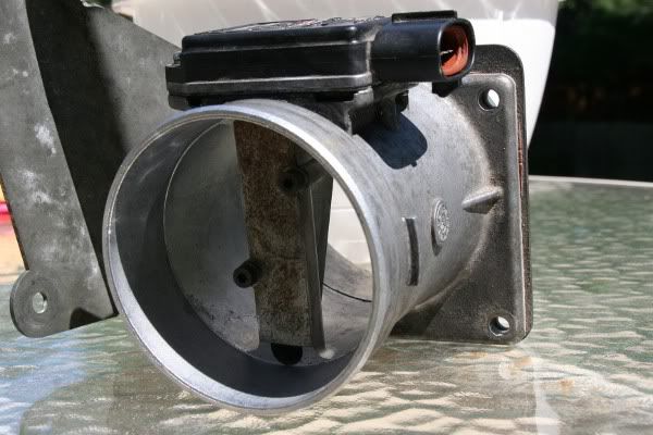

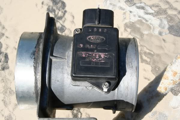

Help me identify this MAF
F3VF-12B579-AA
AFH80-01
5E15
I dont know much about this MAF but I do know it is a 80mm. What car is this MAF from? What injectors are used with it? Is this a matching/calibrated MAF for 30lb injectors?

I think it's for a 1993 Lincoln Mark VIII

What injectors are in a mark 8?
It is. This MAF is 80mm and is calibrated for 24# injectors.

So if someone on the corral sold me this MAF with 30lb injectors and said it was a matching MAF would he be wrong?
