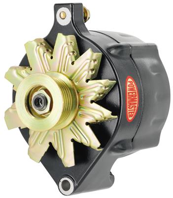

Steve
I am running a powermaster one wire got it in natural finish. works great and was easy to install no mods to the bracket, comes with a power wire.

I used Powermaster on my 5.0L. Fits w/o mods. Summit # PWM-8-57140

PWM-47140 $156 from Summit
comes with power wire
You may be able to get it a little cheeper. I had to wait a few weeks to get it in natural but it was worth it.
