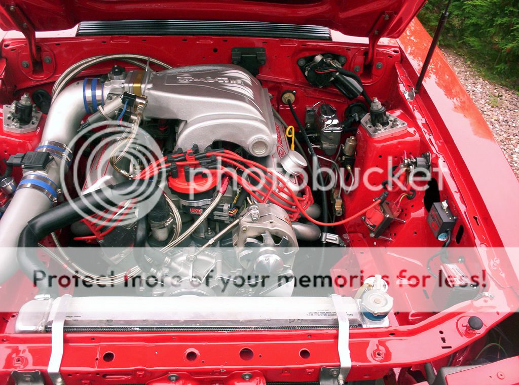

Ok, so I took the one wire off the alternator, started and ran (badly still) for say 10-15 seconds. Battery has now gone up to 20!!!
This car had wiring mods before I got it. Strange thing was it had the main starter cable on the right post of solenoid and nothing on the right one (trigger wire)
4 years and a new engine etc; just clicked no start. I move the cable to left post add signal wire to right post and she cranked n started.
I will add a photo of the solenoid with old setup. Have I created an issue doing this?

if your starter has a solenoid, the starter power should be hot all the time to the starter, you are only switching the signal to the solenoid on the starter.

Looking at your pic, the starter solenoid is mounted near the shock tower. The solenoid doesn't care which side you put the wire on.....meaning the load side to the starter can be on on term and the battery side can be on the other.......choose. its just a switch controlled by the little wire. You apply 12v to the little terminal and the switch makes and sends voltage to the starter......a heavy duty switch with a coil to pull in the contacts. Just make sure you put all the other stuff on the same side as the battery side of the solenoid.
