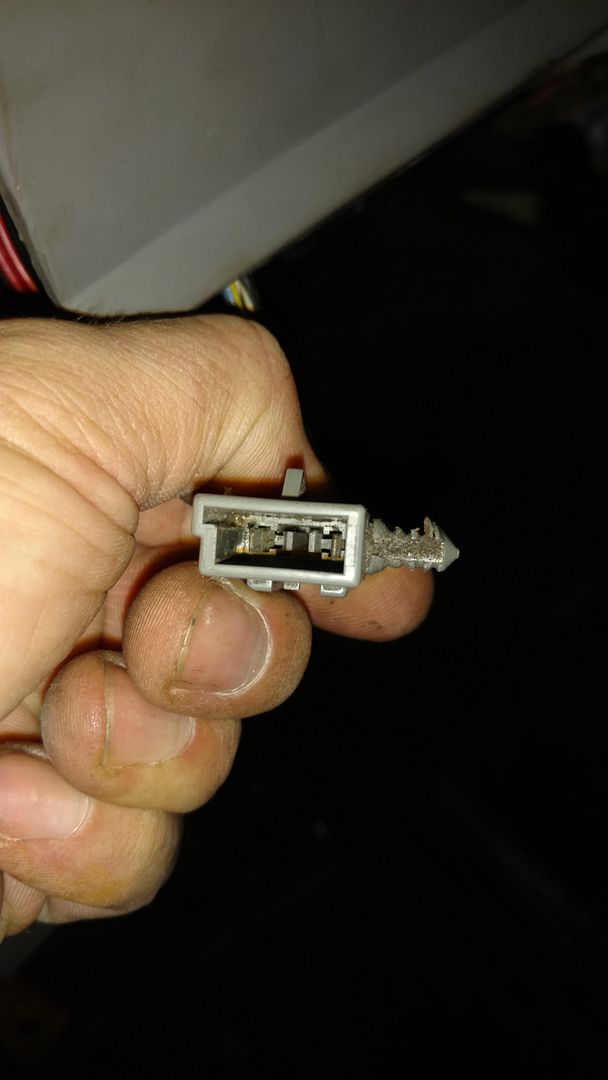

Alright guys, I've had my dash in and out about 4 times now...and this time its going back in for good. This connector is giving me fits....I can't figure it out for the life of me...
Thanks for any help.

Pretty sure its part of the neutral safety/ clutch switch setup.

Were you ever able to confirm where this connector goes?
I have the same exact dilemma.
I have a 1988 Mustang GT convertible (5-speed manual transmission) that I've owned since new. It hasn't been my daily driver for years and I only drive it very infrequently. The last time I drove it I noticed that same exact connector pictured in your post, hanging down from behind the radio on the driver's side. As you know it's very difficult to see under there and I can't see where it would connect even after removing the radio. I really don't want to remove the dash to figure it out.

Yes it's an auxiliary connector for the clutch neutral safety setup. I don't know why they put it there but it's not needed
