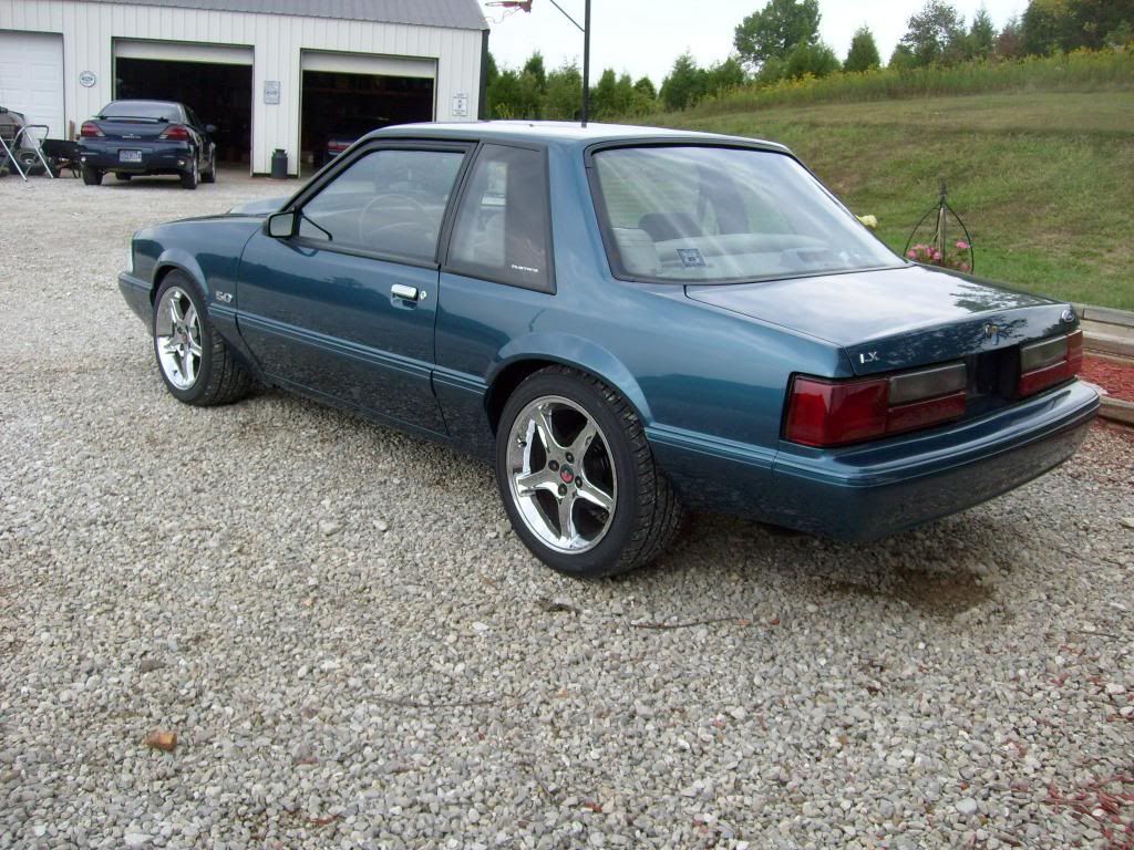

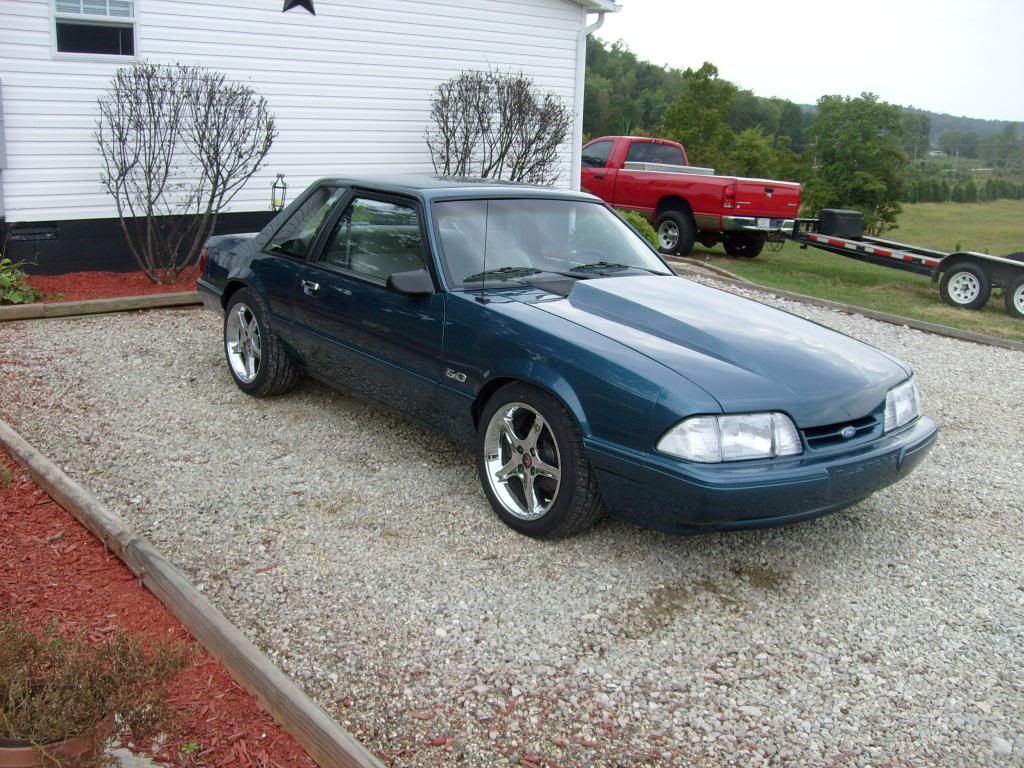

here's the enemy......

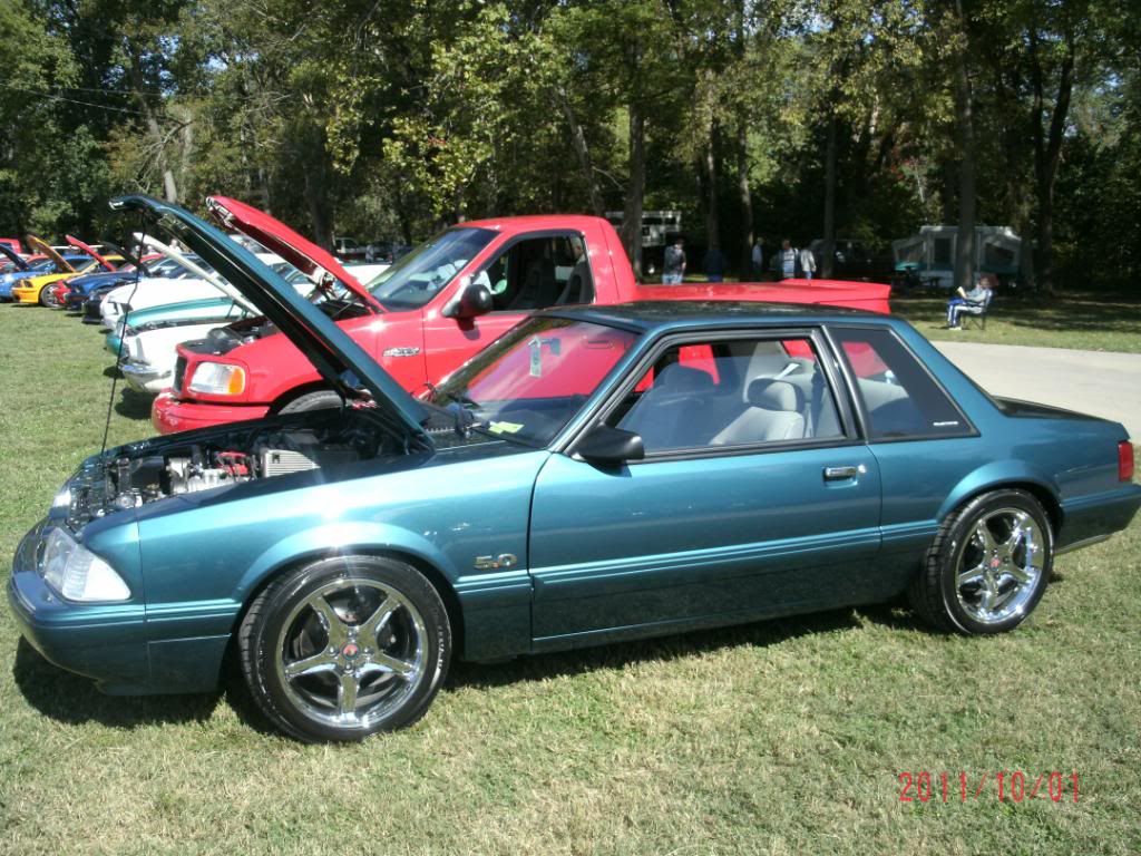

here she is in b/g

That is one sick a## coupe man !! Sweet congrats

thanks bud she's doing fine and we've put about 2000 miles on her already
