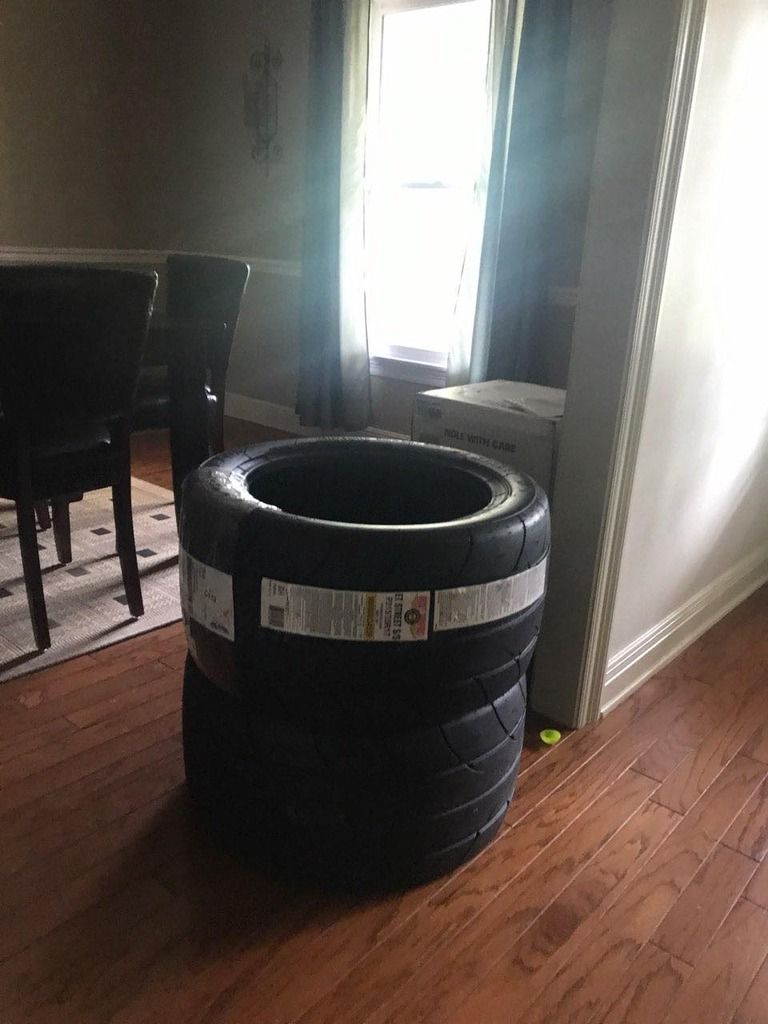

I've done a ton of research on this placed the orders now just waiting.
Ordered 315/35/R17s Mickey Thompson ET Street S/S
Ordered 93 Cobra replica 17x8.5s
Ordered weldcraft wheels widen 1.75in
End result
93 cobra replica wheel
Offset = 48
Backspace = 7.01"
I looked at this from a few angles I really wanted a 10.5in wheel but I think I would have needed a 1/4in spacer and didn't want that I know for sure the 10in wheel would work but I wanted the tire as far back as possible so I added the 1/4in may end up wishing I would have added the other 1/4in but want know till I put them on. Regardless couldn't find a solid answer online so I'm going to make this thread for the next guy.
Page 3 post 51 is the best info I could find.
https://www.svtperformance.com/forum....174839/page-3
This was very helpful and should help anyone who doesn't get how it will fit with the replica offset
https://www.willtheyfit.com/index.ph...et2=25#content
