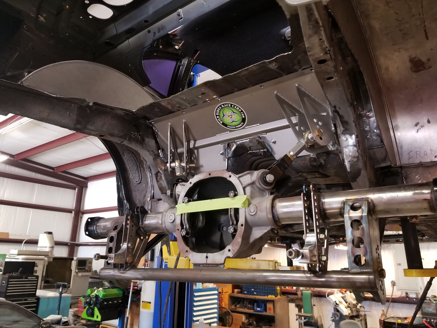

Looks like we are cutting 3" off the housing end, clearing the brackets from the tubes and welding on new bearing ends. Should give an overall width of 48".
Not ordering axles until we measure BUT....
FOX LENGTH AXLES VS. SN95 LENGTH AXLES
79-93 Mustangs - 29 3/16" long rear axle.
94-98 Mustangs - 29 31/32" long rear axle.
99-04 Mustangs - 30 11/16" long rear axle.
So if we take exactly 3" off, we can order a 26 31/32" axles. But we will measure first.

Went with 2.5" Off each end and Strange 9inch bearing ends. Called Strange and got 25" long 35 spline axles on both sides with Spool. Gives me nearly 3 full inches of spline engagement per axle. Went with new 3.73s from Richmond and ARP fastners. Hate on the chrome cover. It is only a stand in until the other cover comes off back order.
Wheels are Billet Specialties Street Lite double beadllock 15x12 with 6.5"bs

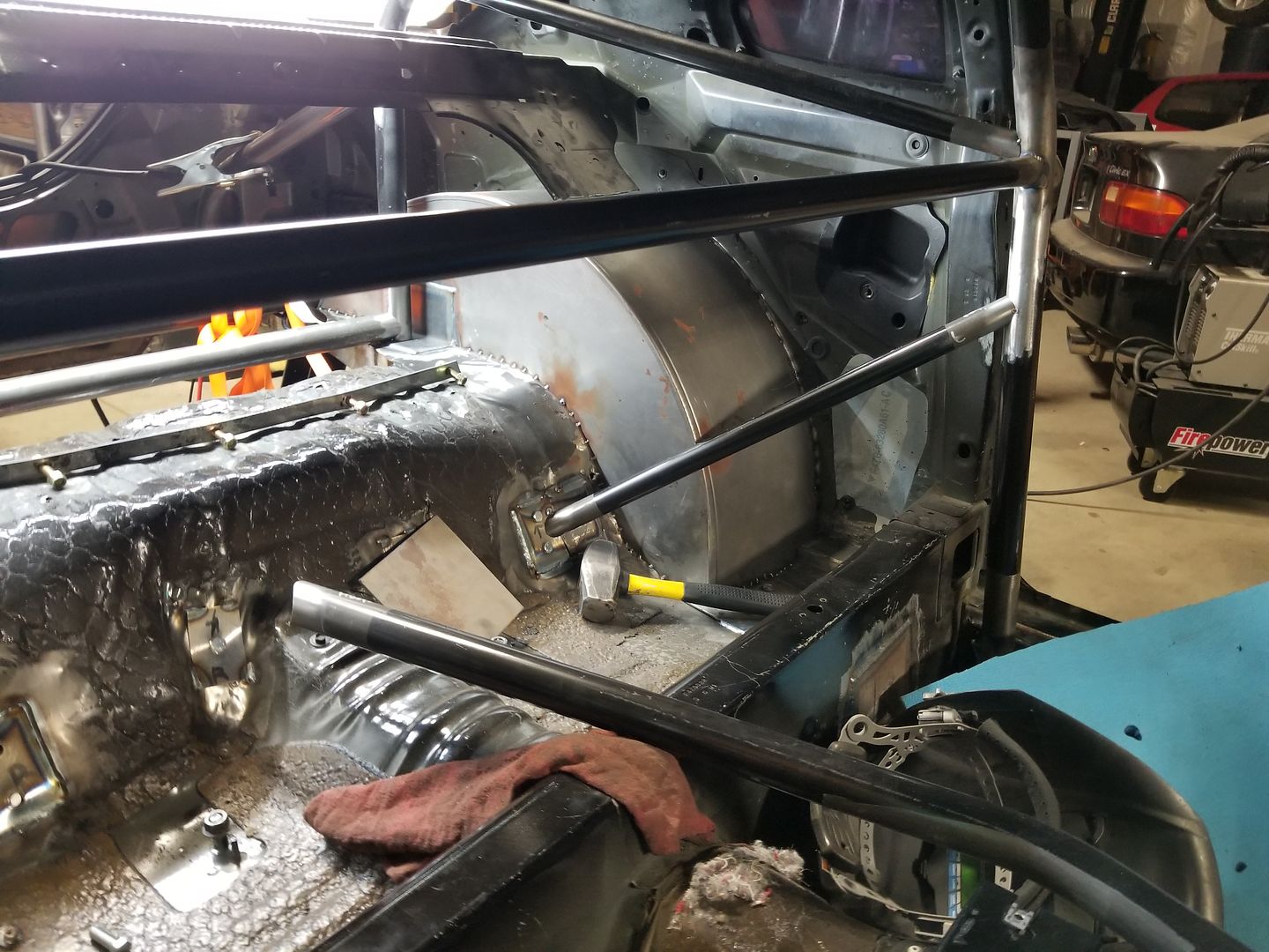

Looks good. Are u going to tie the cage to the upper control arm mount?

Yes. There are bars coming off the main hoop to the plates backing up the S-box. And the S-Bix is welded to the body and frame rails everywhere it was close enough.

Ok good. If u can tie your subframe to it helps. Also your front rear bars from your cage to the subframe helps out to.

The main hoop has a diagonal bar going to the subframes as well as the hoop sitting on a box outrigger. Both doors have rocker bars and we are X'ing both door bars as well.
Might even bring front bars to the strut tower from A-pillar bars too.
The car is as gutted 1994 Cobra. Cage is Team Z 10pt with all their extra bars offered.
