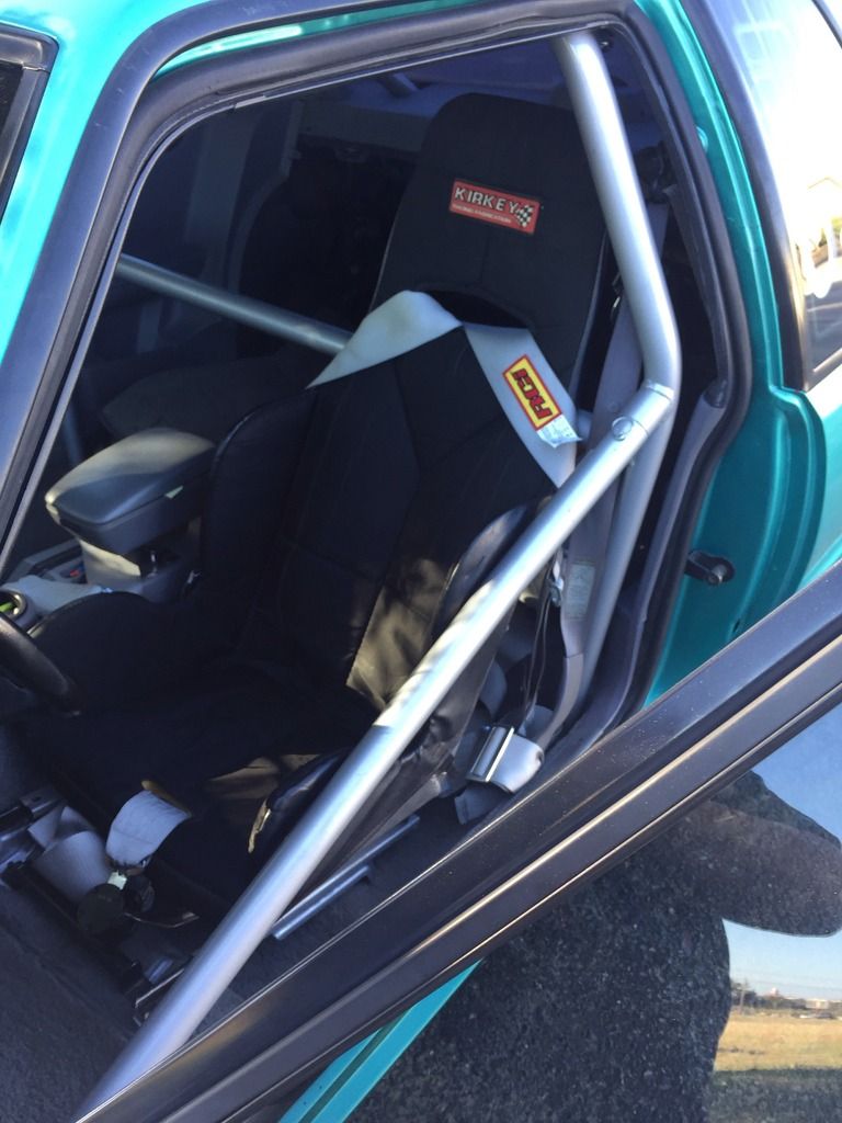

I bought a 6 point cage from Wolfe Racecraft on Friday and installed it this weekend along with some strange 10 way struts. So I won't get fussed at for no cage now.

Why did you decide to go 6point bolt in vs 10point weld it? Im on the fence because its a street car. But my goals will require a 10point.
