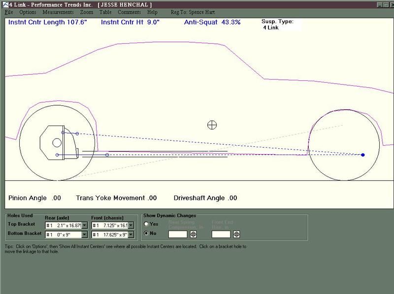

14/130lb coilovers up front. PA Racing cromoly member and arms.
Strange single struts set on #2 from full loose.
Team Z rear springs & lower arms. Baseline uppers.
Strange single shocks set at #4 from full loose.
2940lbs with me in the car.

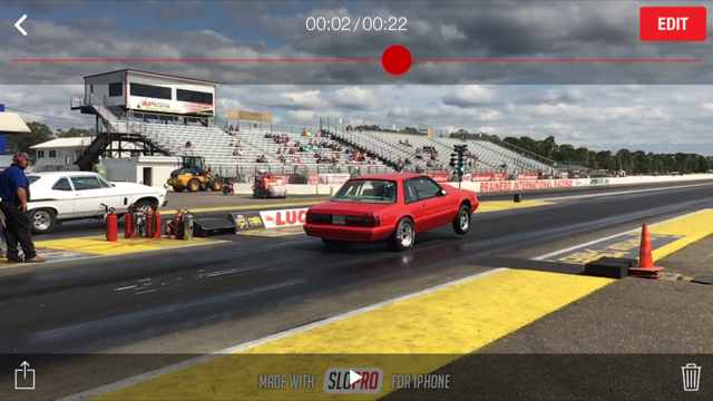

Great video! It looks like the sidewall is deforming right at the hit and begins to spin. The instant center appears to be short and fast acting. The suspension appears to hit the tire hard and then it immediately bounces back into the fender like a basket ball. If you had double adjustables I would try going tighter on rebound to slow the hit and tighter on compression to hold the tire there. I bet it would respond to a stiffer sidewall like the MT 3053S. Just my two cents! Car looks really nice!
Thank you for the input! I'm stuck using a DOT this year for the class I'm running so choices are a bit limited. I'd love to run a radial but I haven't had a chance to narrow the rear end on the car and with the Aerospace brakes it's pushed the wheel out more than I like. I'm pretty sure if I go to one it's going to look like dumbo and I'm going to have major clearance issues with the 6.5" back space wheel. I've had my eyes on those Viking's, I guess it's time.

I was down at Norwalk watching the stock eliminator cars. I filmed a bunch from the side - like your video. In slow motion they all dead hook the tire out of the hole. I would keep taking film and watching slow motion. Tweak the setup until the tire dead hooks. That will be the most consistent and I imagine the tire will last longer too.
You may want to mock up a larger tire before you go to the trouble of narrowing the rear end. I have to run a 1/4" spacer on my car with a 28x10.5 stiff sidewall Hoosier mounted on a 10" rim. I beat the snot out of the inner fenders and rolled the wheel well but I have trouble with the spring pocket area (cant be moved). The width of those aerospace brakes just might put you in a happy place!

I threw away all the AS measurements and stuff, and just tuned by watching a video. One thing I found is the upper arms did very little at the hit. The lower arm's angle between rear end bolt holes and front end bolt holes had a large effect.
I believe plotting arms is a waste of time, because the upper arms do not push on the chassis like a suspension that has close body connection points for the upper and low to the chassis. The Fox has a very wide spread with short upper arms that are angled. All they do is pull back on the chassis way up high.
On my car the upper arm positions mostly seem to control the longer term lift of the front.
By angle through the bolt holes of the lowers, I have a lot of separation dialed in. Using a real stiff sidewall MT SS 295/55R15 tire at 14 psi, I get hard hit without any sidewall distortion. I managed a much faster 60 with a Hoosier slick than a MT 3055S, but my 3055S might have been worn out. The Hoosier was much stiffer, and that lets me run less air and more hit. That helps with high power launches, and got me well into the 1.1 sixty times. This is almost .1 better than any MT tire got me, but in fairness the MT's might have been shot before I had the suspension right. I have to buy and try brand new MT's to be fair.
With the street DOT legal full treaded radials, I have only done 1.2 sixty foot times. This might improve. I have Strange ten ways, and I run the second click from full loose with the street tires at 10 psi boost (ramping up after release) and 4100 RPM launch on a 6300 stall converter, and with slicks I run 5 clicks out of ten and launch at 5200 with trans brake boost at 20 psi. The rear arm angle hits the tires pretty hard, then I apply more boost.

That slow motion video is great, Jesse. I could see you getting a lot out of something like that. Hope you get it sorted out. Car looks great.

Looking at the video, I hear a bog or hesitation sound to the exhaust in the 60 ft area. It sounds like it needs more converter or something wrong with mixture or timing at the start.
Listen close to 1st gear sound as the car is rolling.
https://www.youtube.com/watch?v=DuR0Q3-SsHs

The more I listen the more it sounds like the converter is too tight. Is there a data log??

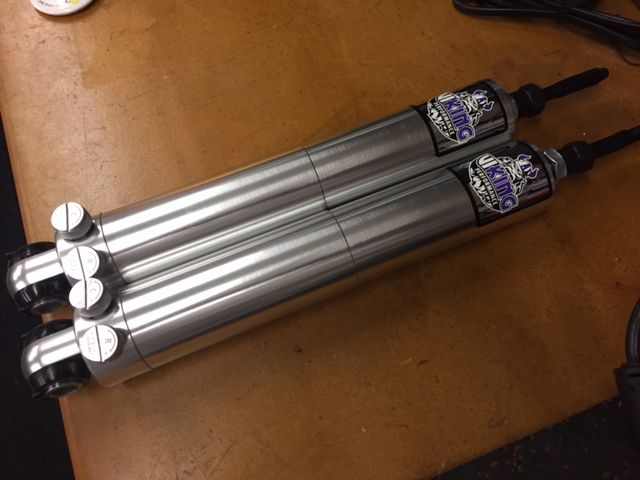

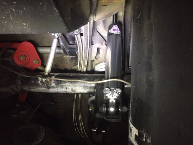

Well... I said I wasn't going to throw a bunch of stuff at it so I made a quick run down to the local parts store to see what they had. Low and behold they had these on the shelf! I guess it helps when Vikings shop is 4 miles from my house! Cant wait to try them out.

In to see how the vikings do. That video is nothing short of technically amazing. In my opinion, you need to loosen up the front struts and raise the tire pressure to around 15-16 psi. You appear to be distorting the tires right on launch and the front end needs to come up faster to transfer more weight on the hit. My car does the opposite - also QTPs - hooks, then spins. You can see how my front end comes up too fast:
https://youtu.be/tgMk44_lnBc
It kind of pops up, then spins. Your front rises slowly by comparison (I'm about 450 lbs heavier than you).
Also, I'd double check the upper torque boxes to make sure there's no damage. The rear seems to moves around on launch. But at this framerate, it's hard to know exactly what normal is.

I'm going to lower the launch rpm down to around 3,200 next time out and raise the tire pressure up from 12 to around 15 and see what happens. The Torque boxes look good. I leave my control arm and shock bolts looser than I probably should. Back as a kid I had them really tight and learned the hard way about suspension bind.
Originally Posted by Project Reef Blue View Post
Youre gonna love the vikings. I find video is key to set them up. Keep us posted!
If they perform half as good as they look I think I'll be happy. Just for kicks I set the compression full soft and the rebound tight and pushed down on the ass end of the car. It was funny to see it go down and just sit there! In all seriousness though I think I'm going to go out and run them on the 1st pass around 5 clicks from full loose on the rebound side and then somewhere around the middle for the compression. Hopefully that way it'll hit the tire and let it stay planted....? Will be taking a ton of video the next time out.

Instant center off? Possibly converter incorrect for the setup but if it were mine, and the track was "that" good, I'd look at an IC a little longer and perhaps a little lower. Start longer though. The car is not getting up on the tire. It can't. It is spinning them instantly at the hit. When I see this on a 4 link that's set up somewhat decent, the converter is usually too violent at the hit. I ran into this with mine when I put a C stator in. Went to a BCX and had them remove the sprag and lost a tiny bit of initial hit but it actually works quite well now even if there's a very slight decrease in performance....and we're talking VERY slight (1/8 mile)-meaning hard to tell if the track conditions changed or if the weather's done something weird or if it was the converter change. A few thousandths.
Looks like the AS is positive, meaning above 100%. Tire looks as if it's being forced into the surface at the hit, also contributing to the tire being squashed. My thoughts are to remove a little hit, get the AS down around 90% give or take and perhaps try to get the IC out a little and maybe down some. If the 4 link has any adjustment in it. I'm not familiar with your particular setup. To get weight onto the rear tires, the car needs to pitch rotate and it's not doing it, at least not for 20 foot or so. Sometimes getting the front end to "lift" a little more or faster helps, but in this case I think you could take all shock absorption out of the struts and it still wouldn't work, in my opinion. Also worth mentioning, sometimes loosening the front rebound and tightening the bump (up easy, stay up) will kill some MPH downtrack too, which I found on mine. I actually had to limit the front end travel and this was worth almost a full tenth....keep in mind that was with a stock front suspension Maverick, which is really similar to an early Mustang. Apples to Oranges in this case, but an example of tuning and logging what works and what doesn't.
SOMETIMES lowering the launch RPM "hits" the converter (and trans, driveline, axles, and ultimately the tires) harder. Depends on your setup. Everyone's is different. When I was running top bulb stuff (transbrake and delay bracket racing), I decided on a poor track condition day that lowering the 2 step from 5000 to 3000 might help. Nope-made it worse as it was "flashing" the converter a little harder. Went to 4500 and it helped some. Again, everyone's stuff is different and your results may be completely different than mine. Just sharing what I've found, for what it's worth.
Very good video, by the way, and thank you for sharing. I now know what my next purchase will be.....that camera app

We'll give her some more pressure and see what happens. I'll loosen up the struts all the way as well.
Thanks for taking the time to reply! Good info and I appreciate it. I'm going to try and re plot out the suspension here this weekend. I did it a few years back and remember it being frustrating when trying to get the camshaft center-line measurement. The numbers I got didn't seem to plot the way I thought they would so I'm going to try it again.

Vikings FTW! Glad to hear they are working for you. Ive had a similar experience. What settings did you land on?

Yeah I'm sold! Using 0 as full loose I was at 4 on the compression and 13 on the rebound.

Wow thats tight! Im at 10 rebound and 8 compression with my slowish stick car. Keep up the good work and the updates!
