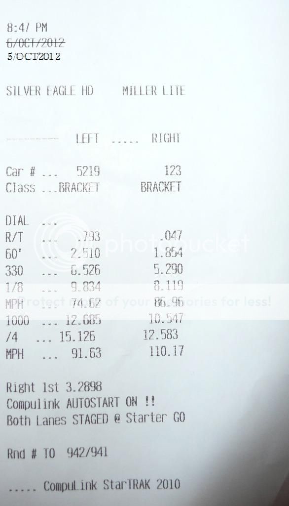

I took my 2011 Brembo car to the track when it was stock except for GT500 mufflers. It even had the stock tires on it which actually aren't bad after you warm them up. The 3.73 gears cause me to shift into 5th before the end of the track so the mph suffers a little. For me the secret to the leave is to get the clutch out and throttle to the floor as quickly and smoothly as you can. It isn't a clutch dump, but a smooth release as the throttle goes down. They should be together and the rpm's should stay consistent. I granny shifted as this car was a driver, not my race vehicle.
Edit: I'm in the right lane on the slip.
https://www.youtube.com/watch?v=WSCNtmmKsrE
Check out the vid above.
