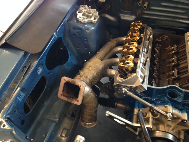

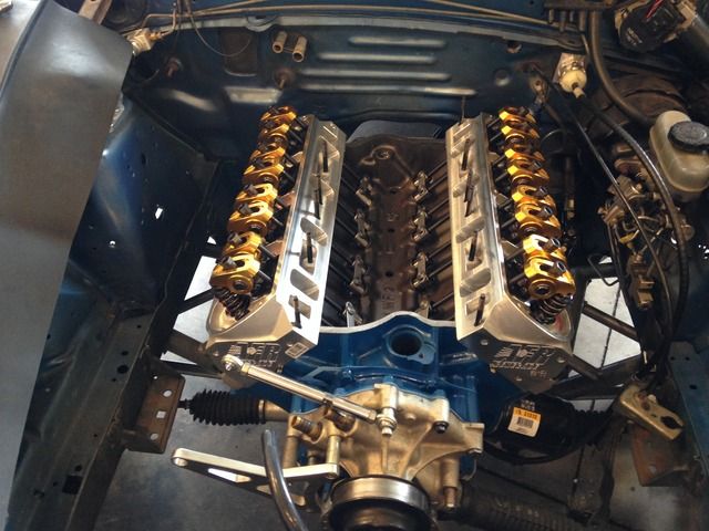

Got the cam degree in, heads on and motor dropped it. Hope to have the Trans in soon. Then into firing the turbo kit

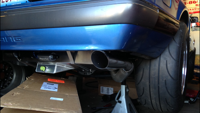

Some 3" flow master tails

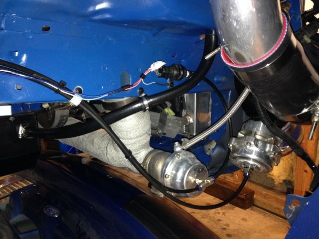

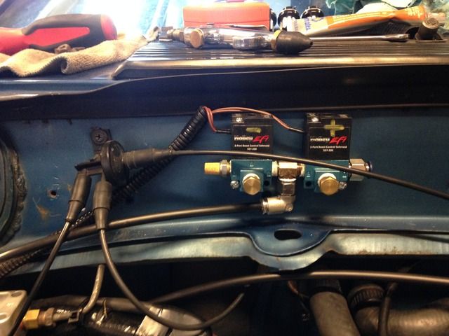

Put in some work on Sunday on the car. Boost control installed and wired. Wired up the Holley.

What fittings do you use for your air lines?

Quick connect vacuum fitings from power adder solutions

Those are also known as "d.o.t. air line fittings. Might be cheaper buying them from a parts store that sells truck parts.
