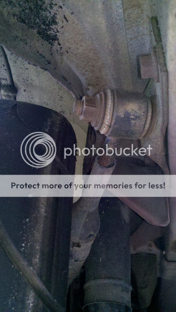

Originally Posted by cobra69 View Post
You know your probably right I think TomR was able to finally to get rid of his by doing something to his heim joints. I don't know what the heim joint is. So now i'm kinda lost.
FYR: A heim joint is an end link employing a spherical bearing which allows articulation, but no movement. A bushing, on the other hand, can (will) deform and allow some sideways, longitudinal, and/or vertical motion.
HEIM JOINT
Andy
'95 GT Vert - Rio Red - Grey Leather - Black Top
TrickVert is offline
