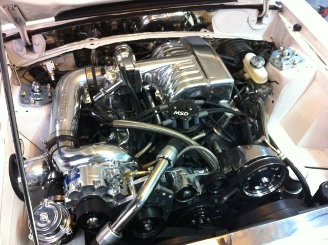

Installed a complete Team Z front suspension in my Fox this weekend. Went to install the Strange coil overs and realized they won't work with my old-school Hotchkis CC plates. Even their site says, "Not recommended for coil overs."
Apparently, the Strange strut shafts are slightly undersized. MM's site says the Strange struts will clunk with their plates because of the undersize. Team Z's plates will work but they are not real great looking. I have a fully polished engine compartment.
What's a good CC plate that looks decent and works well with the Strange struts??

Well even though the Team Z's are not the best looking, from what I've searched, they seem to be made specifically to fit Strange struts and have the most amount of adjustment. I actually like that they are steel as it's more rigid than aluminum.
UPR seems to make a good CC plate, but I have no idea how it fits the strut shaft. So now I am deciding between the two. Guess I could always powder coat the Team Z's, I'm leaning towards them for sure....

The UPR's definitely look a lot better and would match the rest of my engine bay. However, I like the fact that the Team Z are basically engineered around a Strange strut and the bearings are even designed to fit more snug on a Strange strut. Dave Z confirmed this in an email.

I got the Team Z plates and installed them. They work excellent with the Strange struts. Fit perfect and well designed. While not the fanciest, they don't look bad at all.
