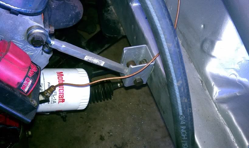

I made my own. I think I got the heim joint at Tractor Supply Company. The bracket on the frame rail is a piece of square tubing I had laying around, I cut the notch out of it with a chop saw or cutoff wheel, can't quite remember. Used some washers/bushings as spacers on each side inside the bracket on the rail.
In my case I already have solid motor mounts, but even with them when I hit the spray, I'd always notice the next day the motor was tilted a little. So even the solid mounts weren't holding well, it was twisting in the cradle, the single bolt through the k-member pad wasn't enough to hold 800+ fwhp!

It makes complete sense for you Carl, your not running motor plates. If you were, the motor wouldn't be shifted in the car after a race.
