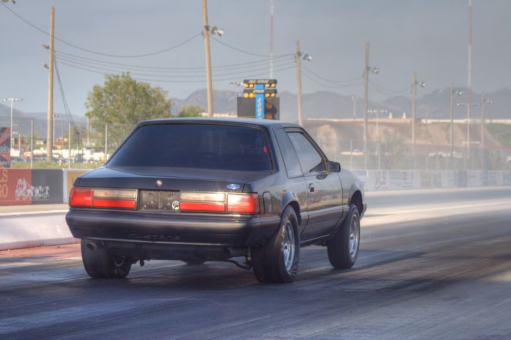

I have one pic of the launch. This pic is from a test and tune so ignore the red light The front is really high up for launch with a 2000 rpm 2 step and half throttle so the front may be popping to quickly. And this again is only a 1.8 60' in the pic. Maybe some 70/30 or adjustable struts to slow the front end lifting?

the car dosent look like it squats at all, id put upr pro series adjustable upper and lower control arms in it w/spherical bushings and get moroso rear drag springs and get some hoosier qtps.
