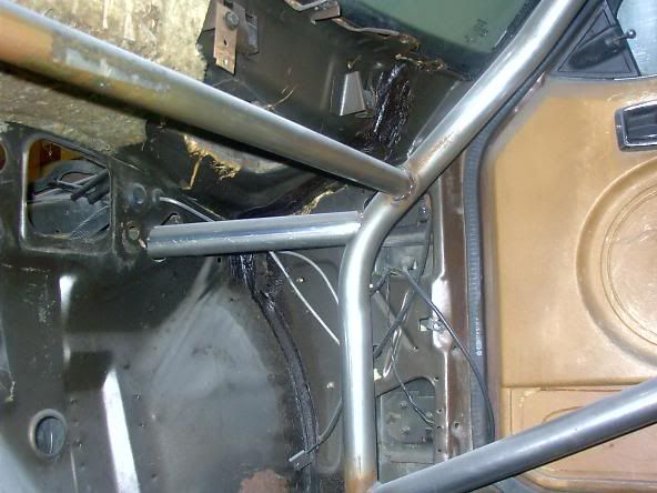

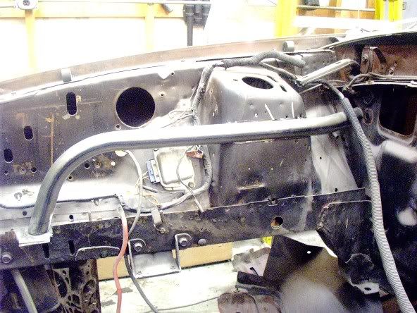

Mine are welded to the shock tower and frame rail next to the motor plate. Don't see how the extra 5 pounds will affect anything but it definetly adds strength to the chassis.
here's a pic

n1vfh81,
So your bars run on the inside of the shock towers huh? Then are just welded to the two 90* tabs on the sides of the towers?
I've seen them ran in two pieces too, cage to the firewall side of the tower, then from the front to the frame....
Wonder which is best? More room in the engine bay the way you have it, for sure!

Do you have any other pictures? Thanks!
MIKE
here's a pic

Originally Posted by 306 View Post
n1vfh81,
I wanted mine ran like that so there wasn't any tubes in the engine compartment. I'm really happy with how it came out. I'm sure either way works just a matter of which one you like.
MIKE
Here's another one. I can take some better ones tomorrow.

I really like them like that! Better then in the engine compartment.
Are they just universal front bars or did you bend them up?
And are they in the way of your side filler panels? being its cut out I assume your do that...
Thanks man!

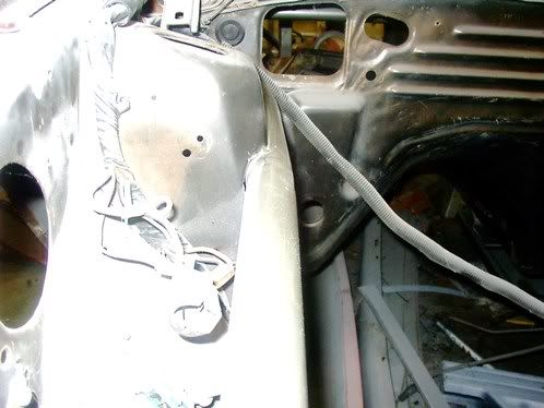

here is a few pics of mine.
[IMG][/IMG]
[IMG][/IMG]
[IMG][/IMG]
Edit: Oops, resize!!!

That looks good and strong too! thanks!
