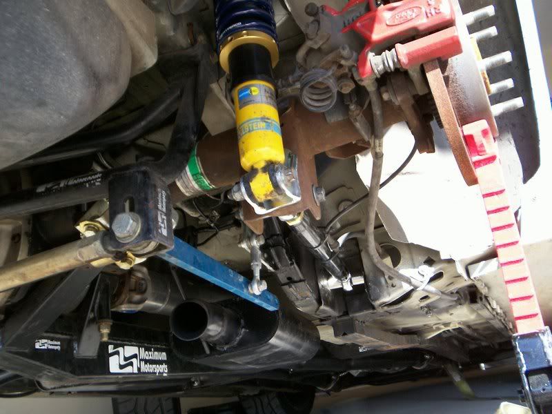

One other drawback is there is a limit to how much torque they can handle. I think the MM site has a chart based on engine torque and rear gears. I pull 1.4-1.5 60-fts with full MM suspension (tubular K, HD torque arm and panhard) with drag coilovers.

Like jw33 I just set the pinion angle. The other things you mention are mostly a function of the ride height and suspension geometry. As long as the panhard is level and you have the torque arm shimmed right for the pinion angle you are good to go.
