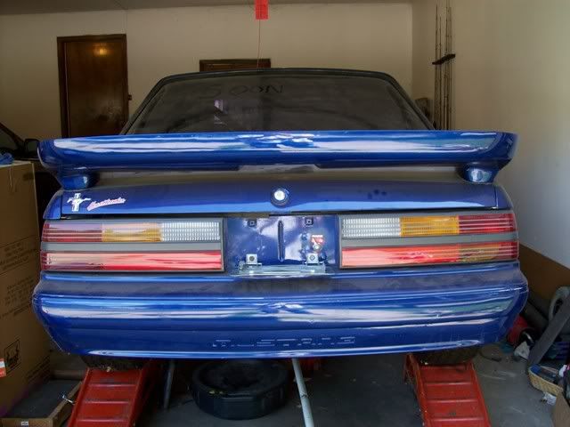

pic of it at all???

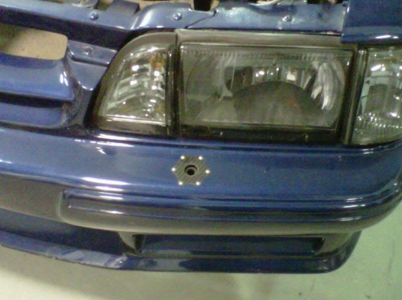

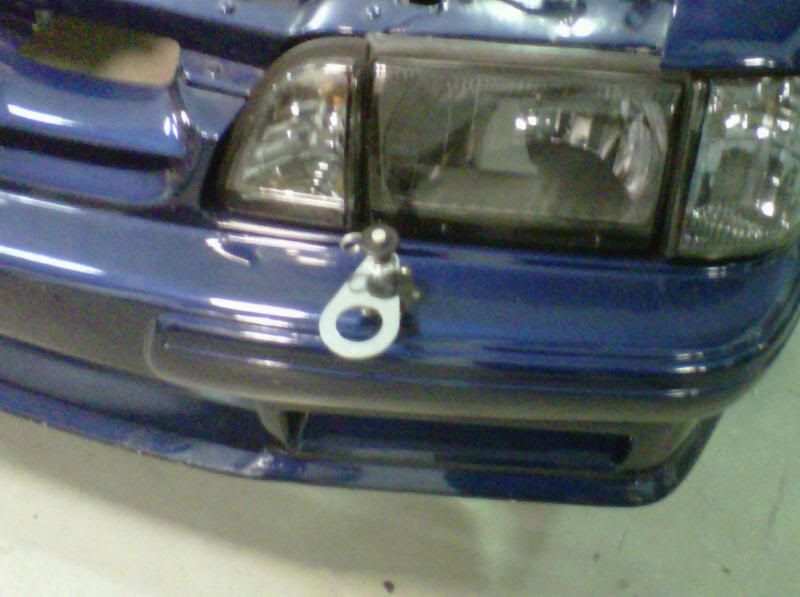

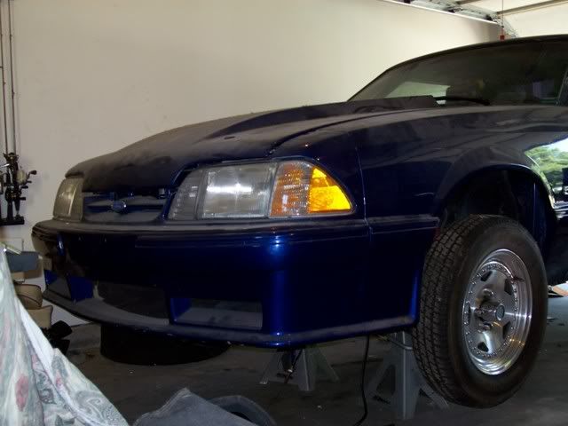

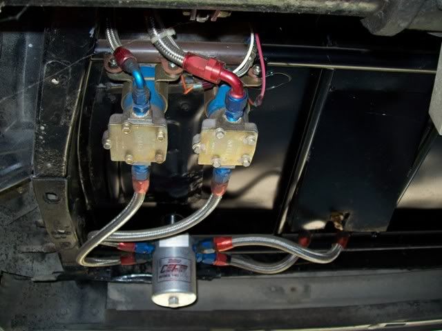

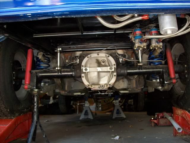

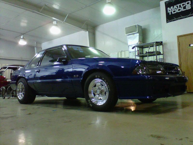

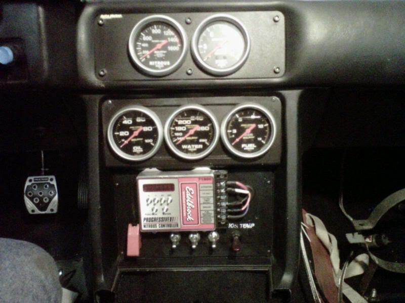

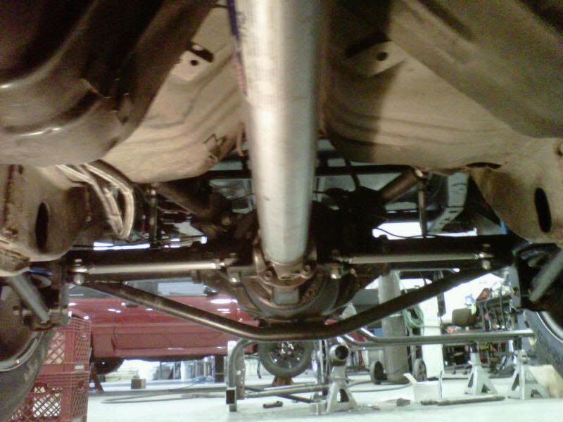

Here's Some Pics:

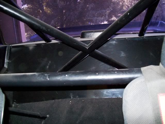

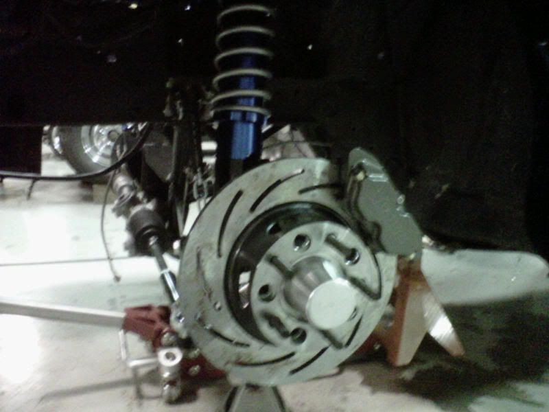

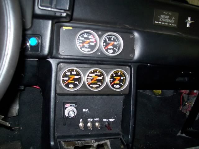

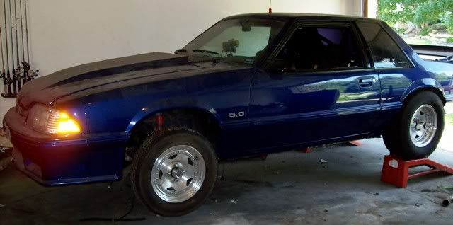

Few More:
I know she's pretty dusty. Thats what happens when it dont move for 7+ years.

LOL well wipe off the dust she looks like a 9 sec car still.. But that wing thing looks 8 years ago though!! Welcome back and hope to read about your build.

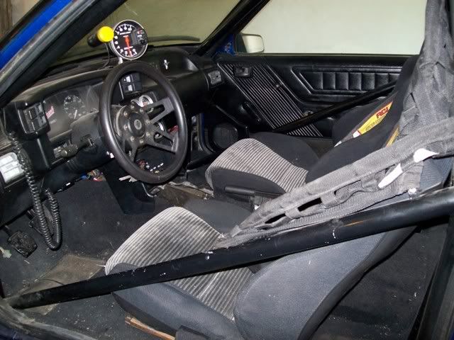

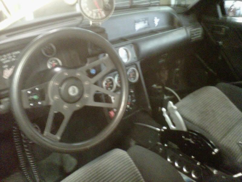

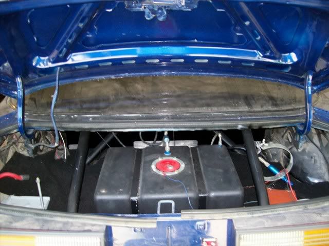

Update on the build..
Tranny plans have been changed to a glide. I am going to race in a local Drag Radial class, and one of the "Top Dogs" convinced me that I dont have the time, money, or crew to campaign a DR4 on a Drag Radial. He said to put a glide in it and worry about tuning one less thing.
I have removed the emergency brake and built a plate around the manual tranny opening, and the E-brake opening:
The plate doesn't appear straight in the pic, but I assure you it is.
I haven't completed the carpet layout yet.
I have also removed the door braces from both doors as well as deleted the wiper assembly. I will be using a Harwood smooth cowl panel.
I have also removed the saleen wing in preparation for an aluminum wing.
The previous owner didn't take much care in mounting the wing. Next year I am planning on a new decklid so I used some "Hole Buttons" I found at Home Depot for a "15 footer" fix:
I have found the NX Dual Stage Nitrous plate. I may have to use it to start next season. Plans are to add a 2 stage "Induction Solutions" direct port system in the future.
My buddy also had my radiator, powermaster 140 alternator, my X-member, and braided line and fittings for my carb. So that was a bonus!
I am still paying for the short block. Thankfully, slwpny has been understanding with that. Thanks Mike.

I was gonna say, PLEASE TAKE WING OFF!! LOL..Bet it feels great to get the ol' girl back in racing shape.

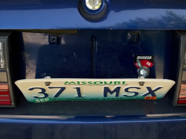

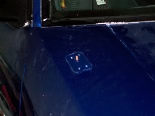

Pics of new Cowl and Nitrous Purge mount.
-Scott

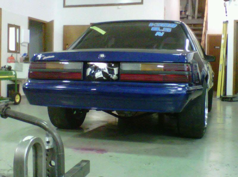

Slow, but sure. getting closer. I removed the Front and Rear bumpers, eliminating another 60lbs.
In order to keep my 82 GT Front spoiler, Jake is fabbing me a front bumper that will weigh 2lbs that will allow me to mount the spoiler to.
I also completed the 2nd stage purge mount:
-Scott

Spring Bump.Winter work has been slow over the winter, so I haven't got as much done as I was planning.
I have replaced the Main fuel pump (Motor supply) with an Aeromotive A2000. I have also relocated the nitrous bottle up front. We are being limited to a -4 line so l relocated it to allow the shortest feed line possible to help diminish pressure loss as much as possible.
I have also taken out approximately another 150lbs, by removing Door Braces, Bumpers. and finally going to front coilovers and tubular A-arms.
Unfortunately, it doesnt appear like l am gonna make the first race May. But still am making progress slow but sure.

post #28 of 53 Old 08-31-2010, 09:38 PM Thread Starter
Join Date: Jan 2000
Location: KCMO USA
Posts: 82

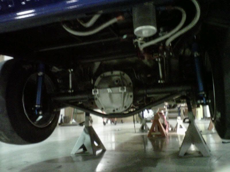

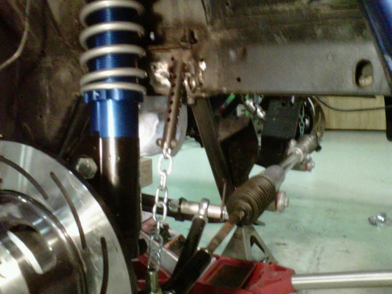

Gettin Closer
Here's a couple pics of my progress. Waiting on heads cam and intake, then will be ready to start testing.
BTW, just learning how to take pics with my blackberry so please dont crucify me....
Pic of Strange single adj. Coil overs, and Martin Connelley's Travel limiters
Strange Pro Brakes, and Racecraft Eng. 2" Dropped Spindles
Braced 8.8 with AFCO 3870-RBG Dbl Adj. Shocks, Team Z control arms, Wolfe Racecraft ARB, Aeromotive A1000 to feed Carb, Aeromotive 11203 SS pump for nitrous feed.
Edelbrock Progressive to control the Induction Solutions Single Stage Plate
Bullet from Bennett. 8.2" deck Dart big bore stroker, topped off with FTI prepped TFS New Style High Ports, and Super Victor intake.
26x8.5 Racing.... Anything else is a Pro Mod Tire...

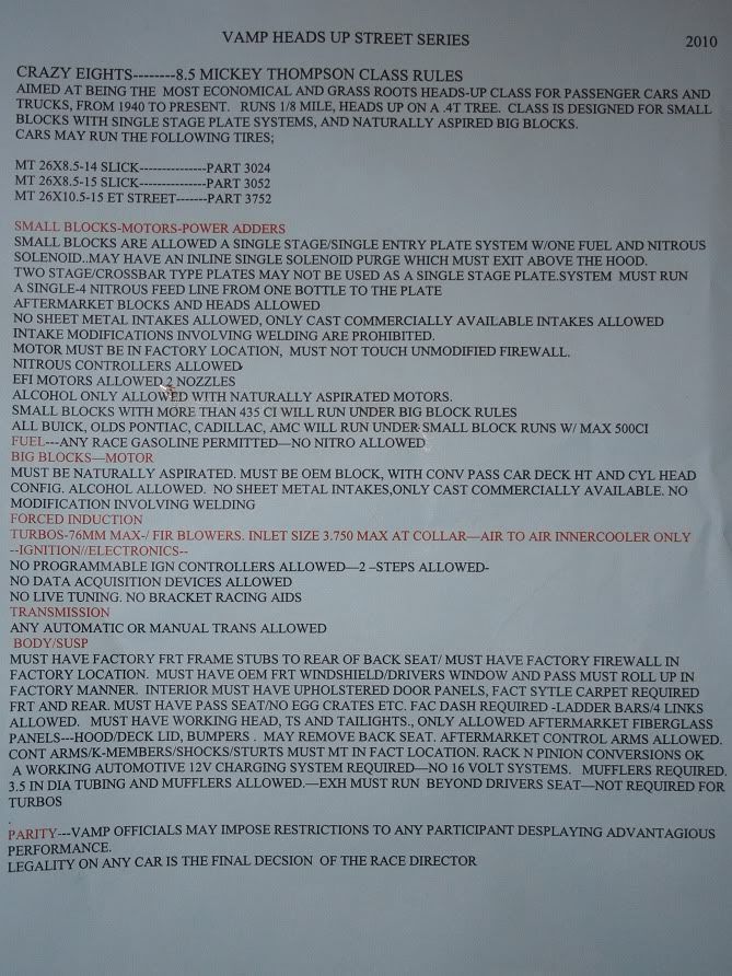

Hey Ian, hope all is well. I am actually building it for a 26x8.5 class now. The D/R stuff here in KC has gotten pretty fast too.
The rules are as follows:

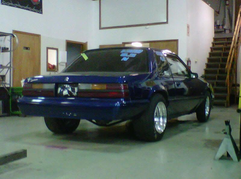

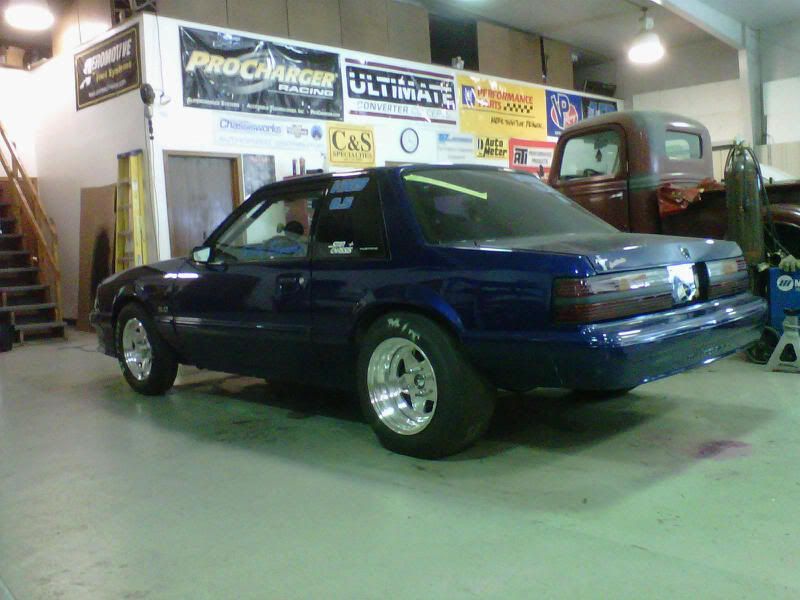

More progress pics:
Hope to have heads cam and intake very soon!

very nice! out of curiousity what size slick and rim b/s is that in the rear?
410W / C4 / 275's /100 shot on pump gas 93
[email protected] 1.37 60' 6.31 1/8 mile (10.4 on motor)
COP_STANG is offline
post #35 of 53 Old 09-04-2010, 10:37 PM Thread Starter
Join Date: Jan 2000
Location: KCMO USA
Posts: 82
It is a M/T 26x8.5 Slick, mounted on a Bogart 15x10, with a 6.75" back spacing.
