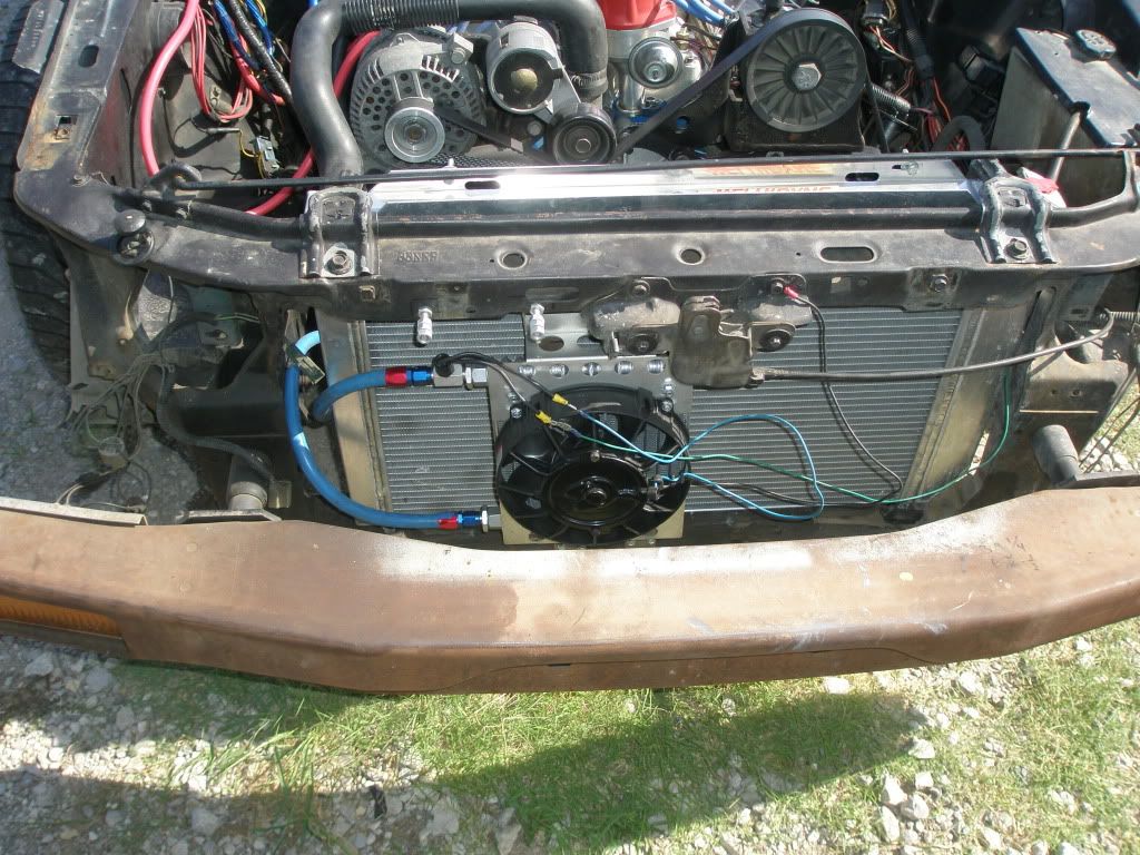

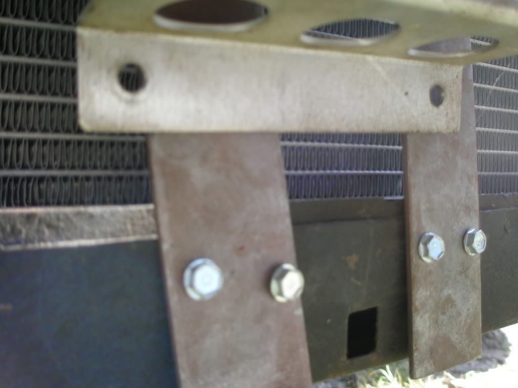

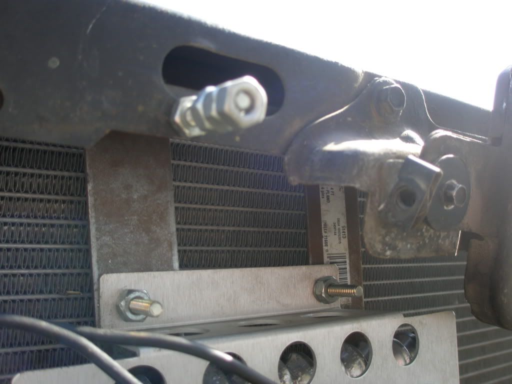

If no one else post theirs up by tomorrow some time I will snap some shots and post it. I made two flat metal brackets that go from the top of the core support to the bottom and mounted the fan to that. It is off to the passenger side under of the radiator a hair.
Also the cooler is maybe two inches at most in front of the radiator, they are super close together.

I got home today and took a few pics for you since you haven't got any yet. Hope it helps. Still need to get it finished up but its where its gonna be for good.
