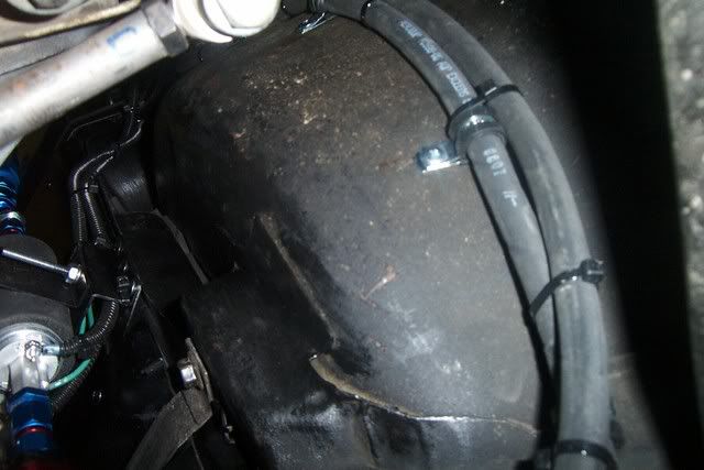

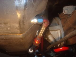

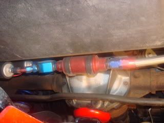

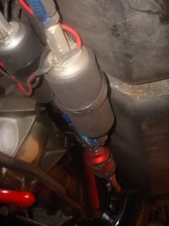

sorry i havent had the time to respond to your pm's. i'll take some pics of how mine was set up when i get home and post the tonight
but real quick if you look both my fuel lines were routed on the drivers side through the fenderwell and tucked and tied to the right of the frame so they are outta harms way
i'll lift the car and get some pics of how we mounted the pumps

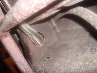

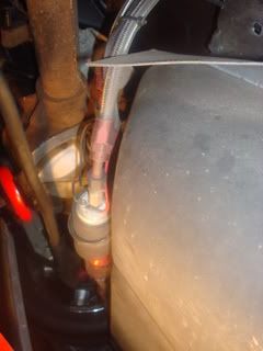

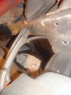

i routed them from the sump then drilled a hole in the frame behind the rear drivers side tire in front of the axle and they exited out the frame in front of the rear tire. then we stuffed them between the car and the jacking rails
IN THE FRAME:
OUT THE FRAME:
