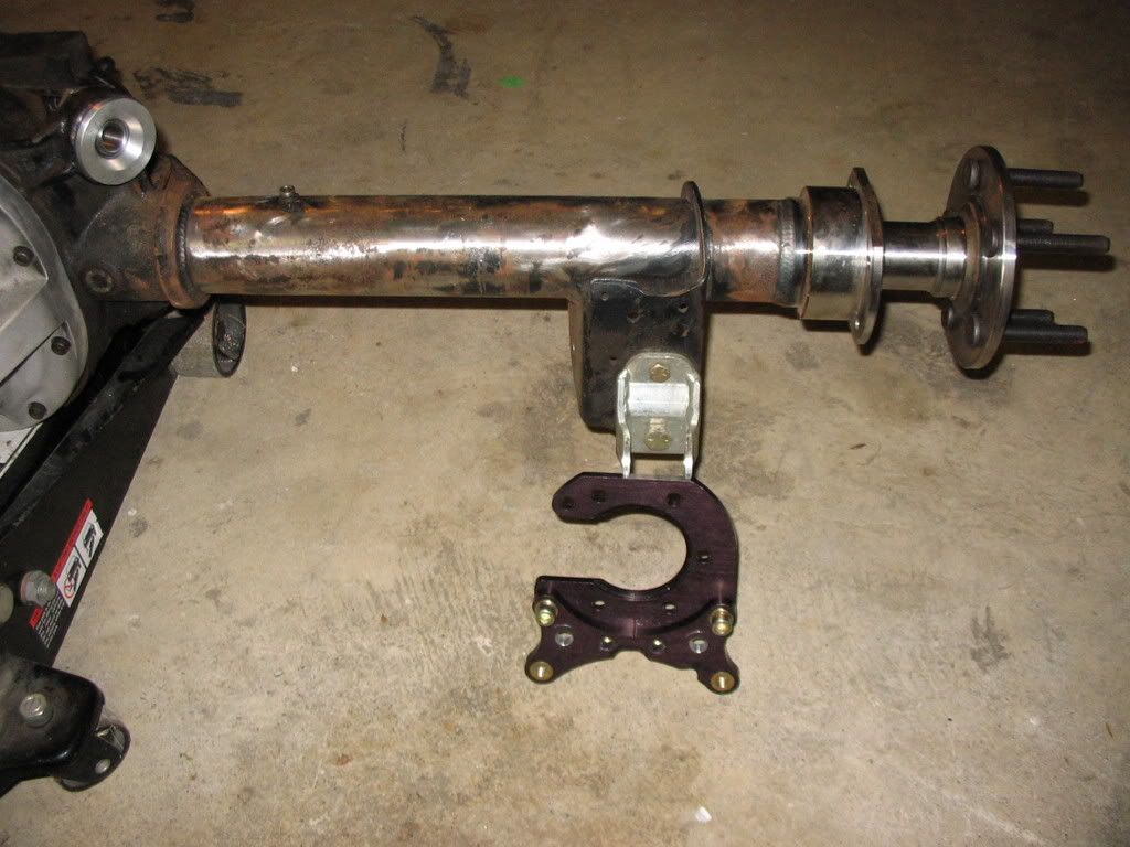

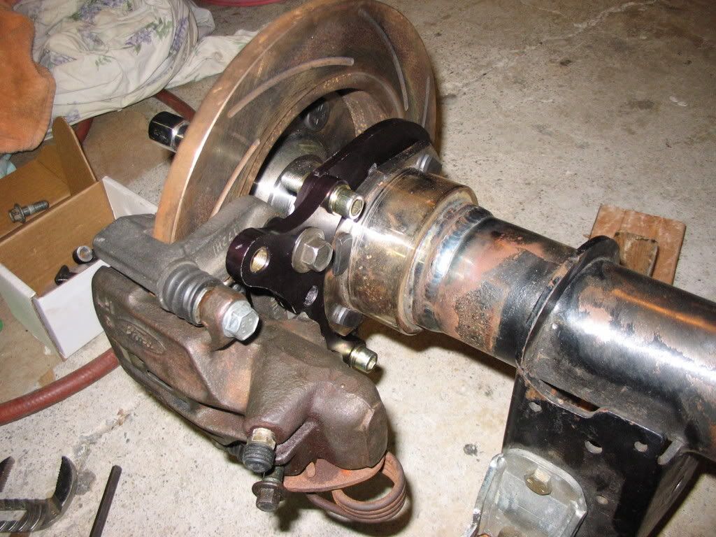

I used a set of Wilwood brackets and machined new holes to bolt up the stock calipers.

This is the best solution I have seen. Do you have a wilwood part number?

bobtsgt what brand ends are those? Are those the late model big bearing ends? Looks nice ! Thanks

I confirmed those are the big late model ends. I am working on the bracket number.

the conversion brake bracket is made by wilwood to match their brake caliper bolt pattern and offset mounting on to a stock "rectangle" bolt pattern on a 9 inch end...
some realignment is necessary depending on the exact "HAT" that holds the rotor.....
they also make a bracket to reuse the original ( 8.8"housings )brake caliper and mate it to a 9 inch end.
Is that something new? I can't find anything like that on their website.

look at what is in post # 8..
it is a 8.8 housing with 9 inch bearing ends and a conversion bracket to mount the stock 8.8 brakes..............
That is a bracket that has been custom modified to work with an 8.8 brake caliper on a Late Big 9" end. I understood your post as they make a bracket specific to the stock 8.8 brake with a 9" end but that is not the case.
I have yet to find an off the shelf bracket that works with stock Gt caliper and a Late Big Ford End.
North Race Cars makes one for the old big style and small bearing ends, but not the late ford ends.
