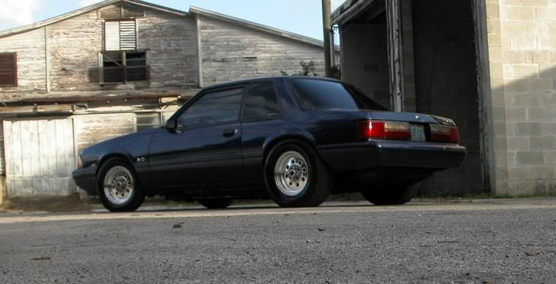

No rubbing problems, with a rolled fenders and 275/60/15 ET Street radials on 15x8 wheels with 5.5"backspacing. Here you go, the best one I have of the stance:

^^^ with a 275/50 tire do you think you would have to roll the fender? i want to put a stock v8 spring in i just dont know if i should cut it at all or not...

Depends. If you have it close to stock ride hight, its probably going to be fine. Lower it much, without the fender being rolled, and it (the fender) will cut the tire. You could probably get away with lowering it if its not driven much.
Its pretty easy to roll or cut the fender though.
