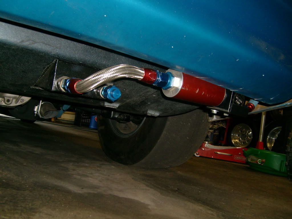

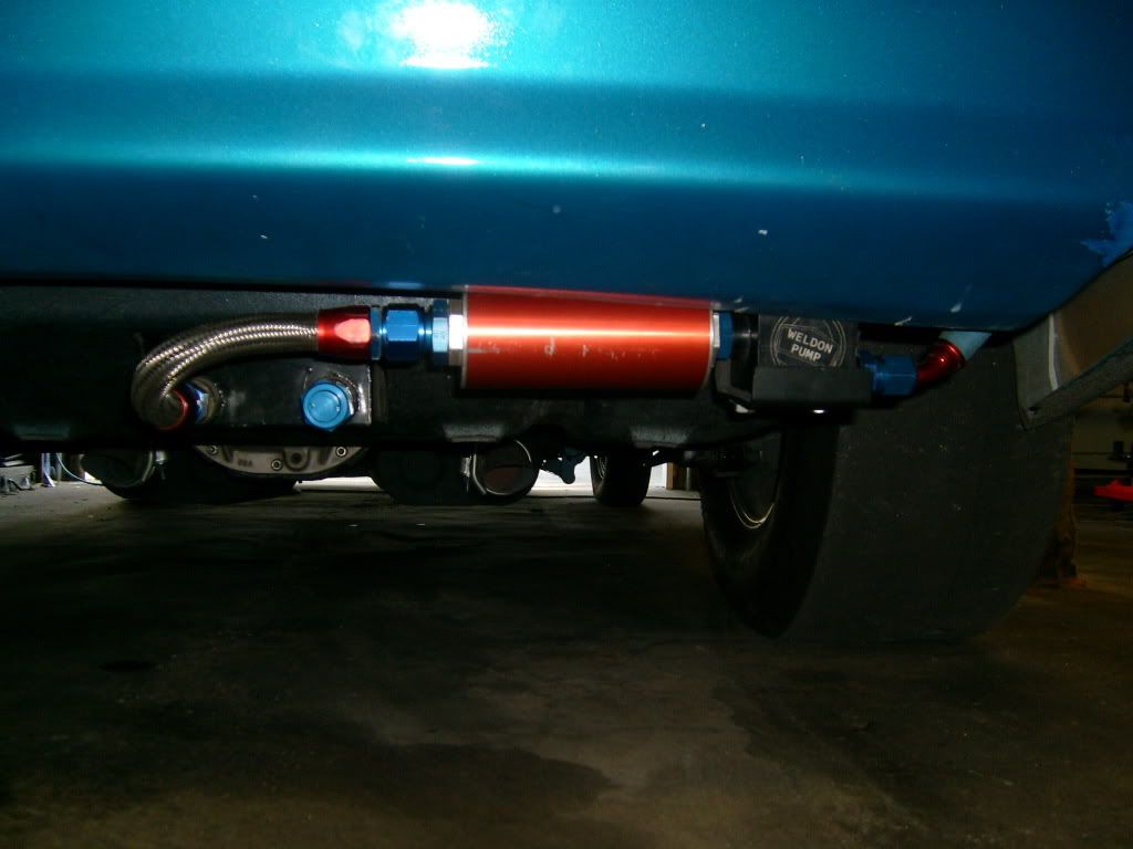

I just made a "L" shaped bracket and mounted it behind the bumper.

AWESOME AWESOME first pic post!!!!!!!! Lets Keep Em Coming!!!
