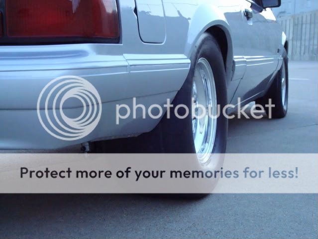

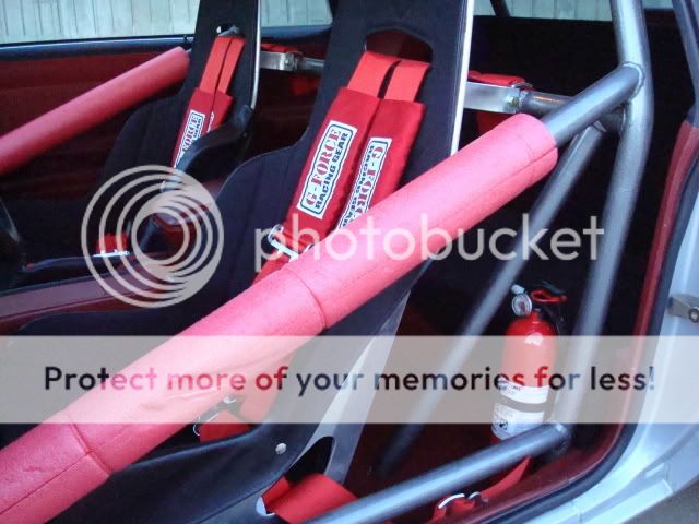

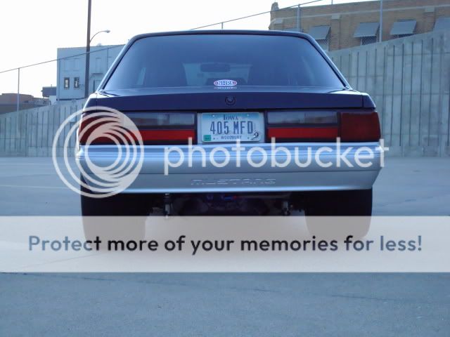

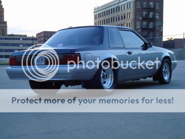

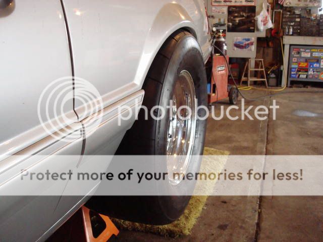

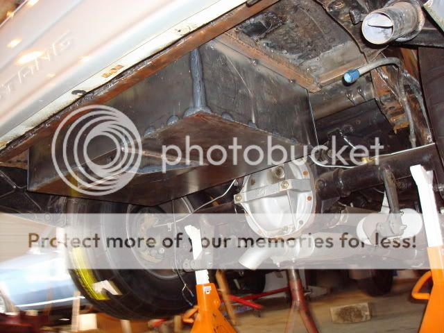

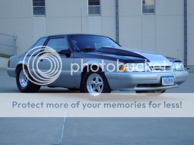

I thought I would post some pics of the minitub/8pt. Cage project I completed last winter. The minitub was quite a bit of work and alittle spendy, but was well worth it. No more tire rubbing! Tires are 325/50/15 Nittos on 15x10 wheel. I did the minitub, cage, put UPR front and rear suspension, fuel cell, and Kirkey seats in it and lost 110 LBS. from last year. It weighs 2900lbs. w/full tank of fuel.
Before:
After: Car sits alot lower

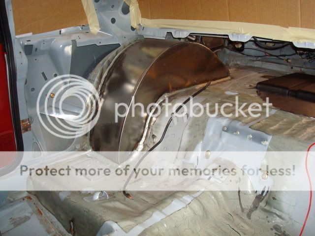

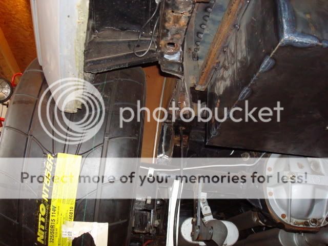

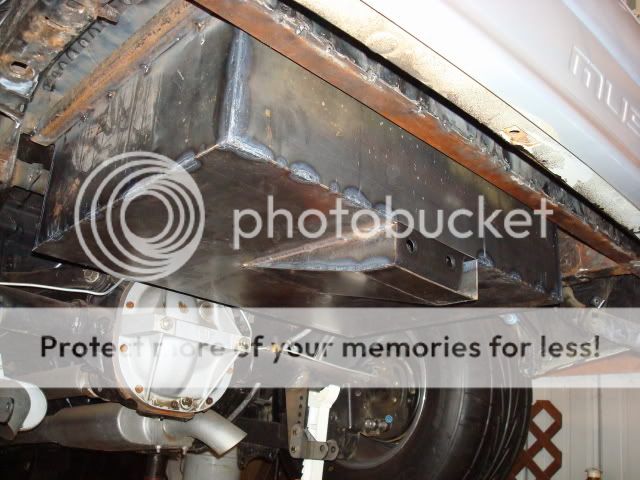

More pics:
Before narrowing axle 2" per side:

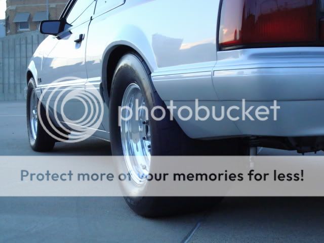

Whats the backspacing on the rear wheels? I saw that you have the rear narrowed two inches per side also.

The rear wheels are 6.5" B.S. I narrowed the axle 2" per side, because i didn't want the tire to rub on the fender lip. I also wanted to lower the rear of the car.

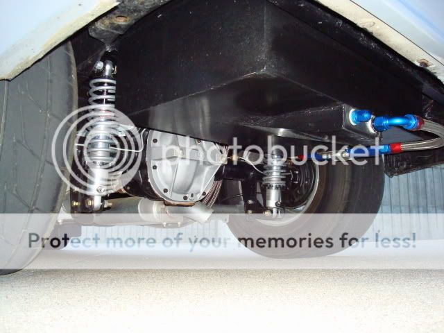

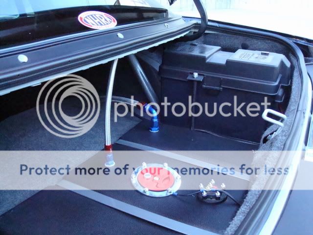

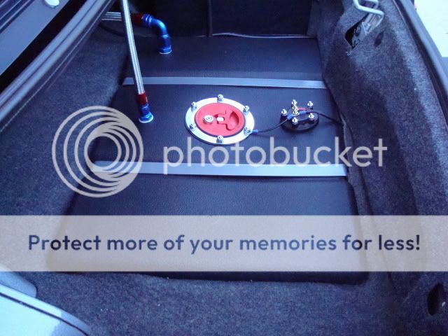

I like the fact that you have the cell mounted low to restore some space in the trunk. What size is it? Looks like 20-22gal.

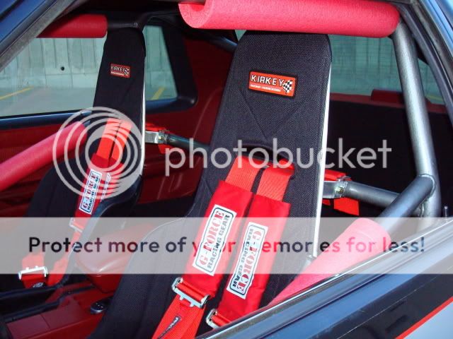

how are those seats?

The cell is 15gal.. The Kirkey seats are surprisingly comfortable. I just got back from a 600 mile trip and my butt hurt alittle bit, but not too bad. Alot better than the Scat Procars I had in it last year.

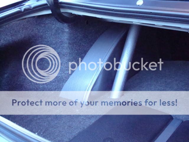

was that a bought cage or did you get a chasis shop to fab one for ya?

The cage is from Wild Rides Race Cars. They prefit it, and all I had to do was weld it in.

is that a mild steel bar?

It's a mild steel cage. Thanks for all the comments!

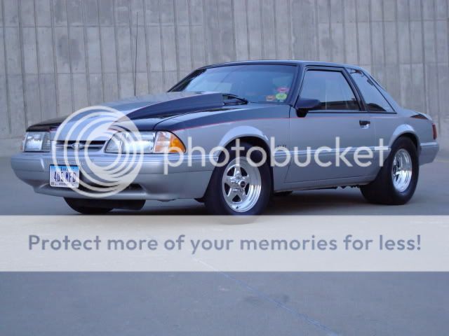

Dude that turned out great and would love to do that to my coupe.. The one pic looks like the front is sitting just a tad higher than the rear but in the other pics it doesn't appear that way. Looks perfect and now I have some more motivation to mine back together. thanks for the pics

The car sits perfectly level. The parking lot I took the pics in was at an incline, so it makes the car look uneven. I wanted to lower the front some more, but the spring is down as far as it can go on the strut. I might have to get a little softer spring maybe?
I know the mudflaps aren't the best looking, but I drive it quite a bit and without them I would have no paint left behind the front tire. I tried it once.

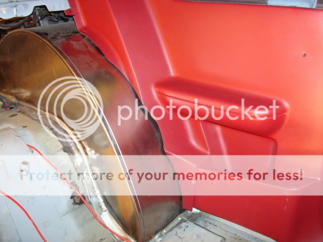

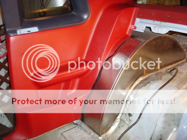

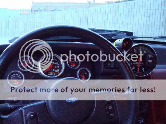

Here are a few install pics. I ordered the minitub kit from Wolfe Racecraft. All of these pics were before I narrowed the axle. I sandblasted the underneath and painted it with POR15 when i was finished. Thought i would show off my gauges too while I was at it. It's scheduled to be in the Nov. issue of Car Craft magazine (next issue), but they photographed it before I minitubed/caged it. So check it out!
