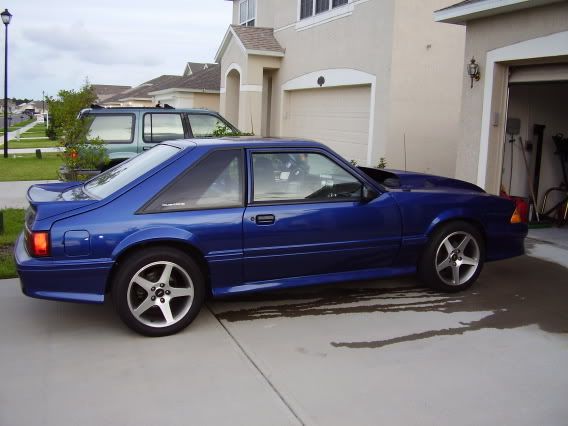

Karl got any pics/site about your car? looks pretty bitchen.

I need to get the new pics of the Supercharger setup. But for the most part here is the body...
