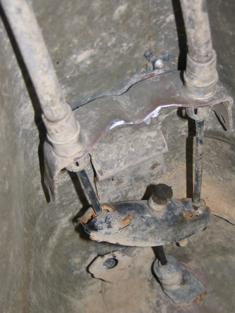

Parking brake bracket modification
I got my new driveshaft Friday. They did a nice job on it.
Before I install it, I decided to fix the parking brake bracket problem. This first picture is of the parking brake bracket with the driveshaft installed. There is about 1.5" of clearance between the driveshaft and the bracket.
This picture is of the bracket with the driveshaft removed. You can see that it is centered in the tunnel. This allows the high point of the driveshaft to come into contact with the low point of the bracket. There is some aluminum from my old driveshaft stuck on it where contact was made.

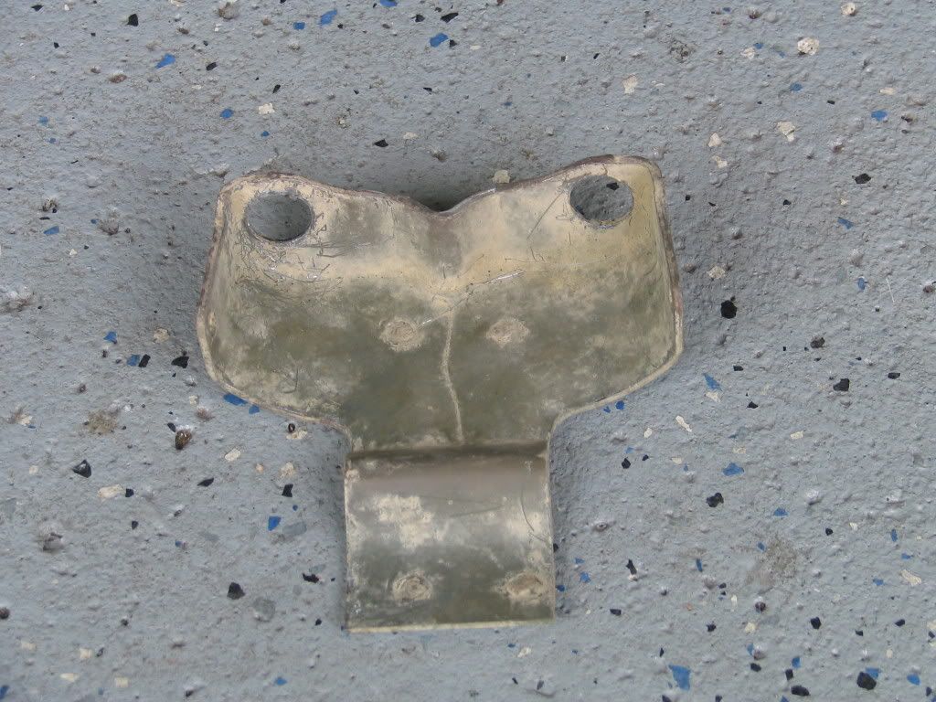

At this point I removed the bracket. I used a cold chisel and a pry bar. An alternative would be to drill out the 4 spot welds that hold the bracket on. The bracket is located just under the back end of the console by its mounting bracket.
I then cut the bracket in half longitudinally and radiused the inner edge for additional clearance. I then drilled 2 holes per side for mounting bolts. I thought about welding it in but decided if I need to make adjusments, bolts would work better.
The transmission/driveshaft tunnel gets taller and wider as you move toward the front of the car. In my car at least, there seems to be less room between the driveshaft and the passenger side of the tunnel. I took what had been the driver's side of the bracket and flipped it and mounted it in the top and side corner slightly more toward the front of the car than originally installed. You will need to remove the console and the carpet from the area where the bolts come through. I cut a 1" or so slit in the carpet and got the hardware in that way. You won't see it because it's under the console.
In determining this location I took into account the length of the parking brake cables and driveshaft range of motion. It appears that now the driveshaft will hit on the floor pan just forward of the rear seat before it will hit the bracket. This morning in an off-road place I can do such things, I pulled a couple of 5k holeshots to see if the bracket will contact my steel driveshaft. It does not appear to have made any contact. I'll check further when I get home.

Follow-up
As a follow-up, I got underneath the car on Sunday and the driveshaft does not hit the parking brake bracket anymore. As I suspected, it contacts the floor pan at a point located below the forward of the rear seat. I guess an adjustable pinion snubber is in order.
I also measured the steel driveshaft and came up with just under 89mm. The new aluminum driveshaft is 89mm and the FRPP I measured at 90mm. I'm going to say all three have the same outside diameter.
gustang818 is offline
Using calipers? I've never heard of the oem shaft hitting the p-brake, but the aluminum one always does. I'd hope ford would leave more than 1mm clearance between the driveshaft and bracket. Nice pics though.

Nice job! Im in the same boat, I may have to buy a new driveshaft as well...mine is scored up too.
I have a buddy who has a 100% stock 94 GT vert and his stock DS hits the bracket..This problem only seems to happen with SN95 cars..

It happens with the stockers too. Mine was due to old sagging springs. That is, until I bolted the bracket up tight with the trans tunnel. My DS has light scoring from the bracket (before repair) but nothing like yours did!
Oh that's the first I've heard about it, I guess since it doesn't leave a big gouge usually like with the aluminum one it's not such a big deal.

exactly, Actually grinds away the bracket and not the DS. The only reason I knew what it was, was that I heard the grinding, then hopped under to check and saw lines around the DS right in that area.
Yes, I used calipers to measure the o.d. of the driveshafts. The variation can probably be chalked up to operator error.
I think like Fastgt94 said, the steel driveshaft is harder material than the bracket. If you look carefully on the left side of the picture I posted above showing the steel driveshaft (it's not the oem shaft from my car-it's out of a '95) you can see a faint rusted over score line from the bracket. I never had problems with the bracket hitting the driveshaft until I put in the Eibach drag springs. The rear of the car seemed lower after that. I measured and there was about 1-1/2" of clearance between the driveshaft and the bracket as originally mounted with the Eibach springs.
