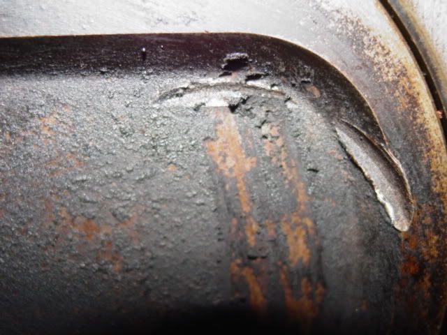

I would check the clearance. Certainly after I pulled the stock iron GT40 heads, ie. small valves, off of this completely stock 95 Cobra R engine (about the same as Lightning but 1.7 rockers) and found this:
Don't know what the hell they did to cause it (missed shift or wrong downshift probably) but I sure don't take clearance lightly anymore.
