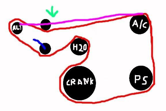

That's because you guys were routing the belt wrong, assuming that you have an idler pulley as well as a tensioner pulley. You have to run it this way:
When you first put the belt on, route it around all of the pulleys, including the tensioner pulley, but not the idler pulley. The belt should run past the front of the idler pulley (pink line). At this point, you may need a helper to move the tensioner pulley over to the left while you wrestle the belt under the idler pulley with a large flat screwdriver. I'm able to do it by myself by holding the belt with my left hand and pulling down while the ratchet holding the tensioner pulley to the left is resting against my left arm/wrist and then using a screwdriver with my right hand to slip the belt under the idler. It's both difficult and painful.
As you release the tensioner to its half way point, the belt will become extremely tight, but when it gets all the way back to its normal position, it will loosen slightly. In the end, you will know you have the right belt length if it is tight and the tensioner makes it all the way back to that normal position.

My car's engine is out of a 91 Mustang. The air pump is removed completely and the system is short belted. It's routed as described in the picture - minus the idler pulley replacing the smog pump. An 84.5" belt puts the tensioner arrow right in the middle of the "range" (look closely - they're marked) and the belt doesn't come anywhere near to touching itself or doing this "rub between the fan and tensioner" -- must confess I can't understand how the fan could touch the fan as it's quite a bit forward of the belt.
