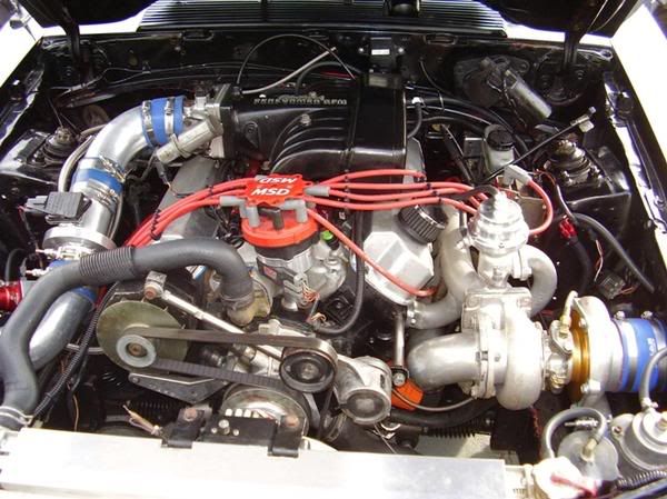

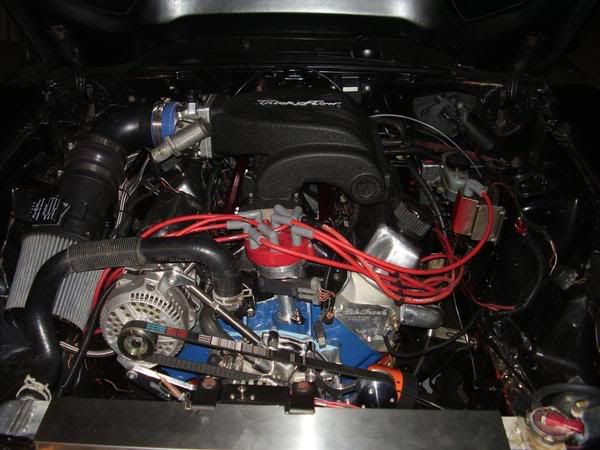

I have a lightning (converted to carb) motor in my stang and its going the opposite direction all my other stangs with 302s and 351s have?? I bought it like this so dont know if its been changed??
current with lightning motor...the top just makes a triagle loop...the others have a idler pulley to change direction ( the belt crosses over the crank pulley then over the water pump)
my 302
my 410 ...hard to really tell..but they go the other way from the current lightning motor???
